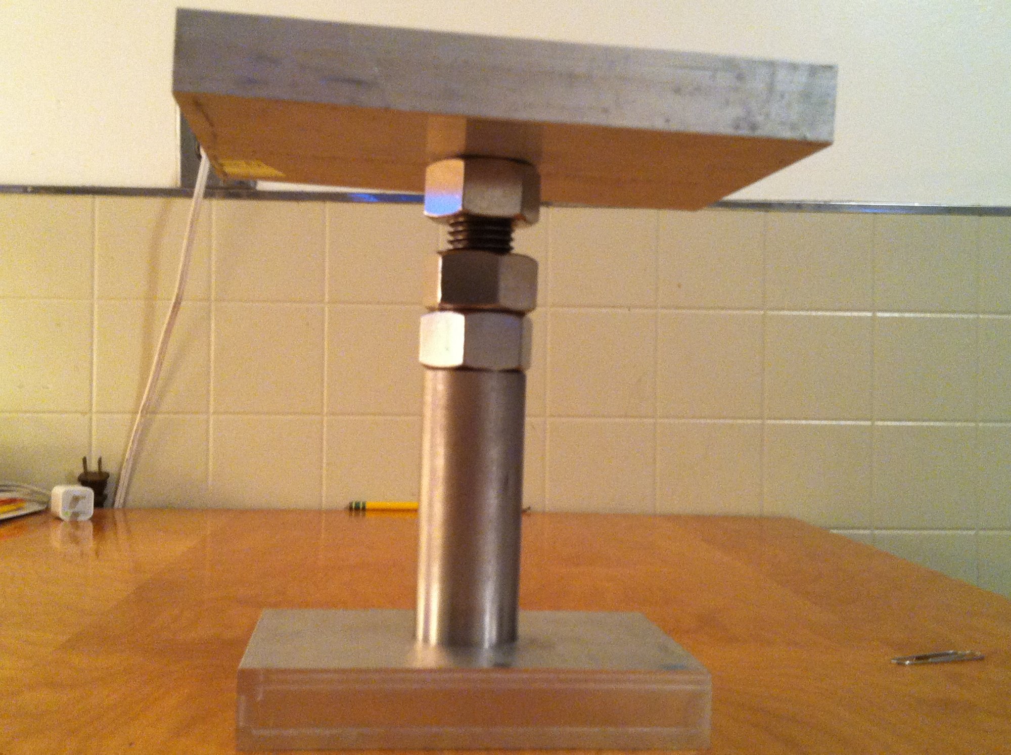

I replaced the one on my ‘88 with an aluminum screw jack that I had made.
Thanks for the tip. Is there different grades of white oak? I found this for $11. At that price it's not worth it to hunt down one from Catalina.
That screw jack looks much taller than the wood I would expect to find inside a mast step. I assume that is for a keel stepped mast?

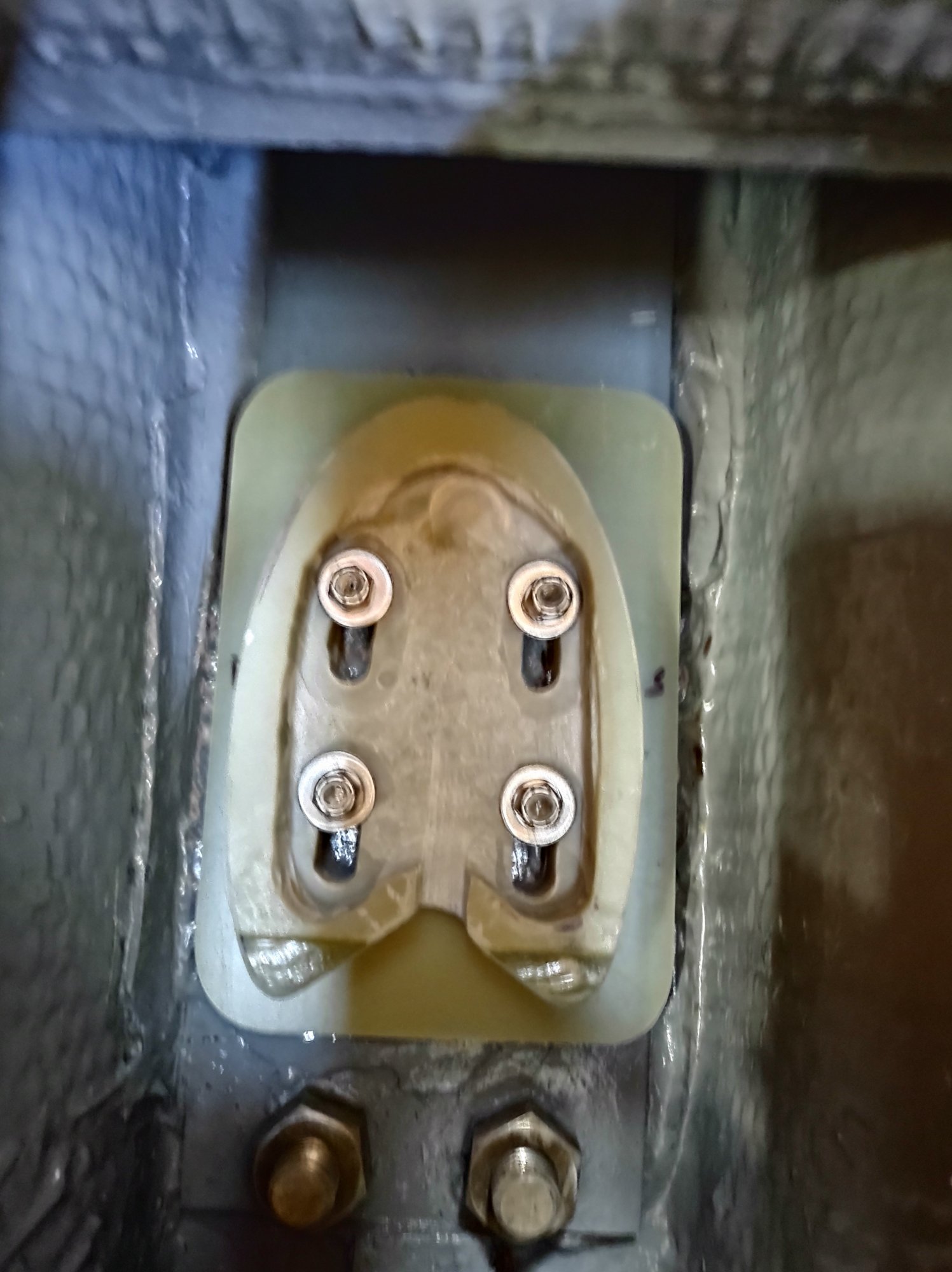

Are you talking about the compression block that is in the bilge or the wood in the deck under the mast. To totally different situations and both crop up on a regular basis. For the wood in the deck, I used G10 to replace the wood. I got extremely lucky in that the wet wood extended out to an area about 3/4" less than the size of the Mast Step Halyard Plate that Catalina Direct sells which is about 11" x 8". I cut out the wet wood, bedded the G10 into the void, beveled the deck back to the extents of the halyard plate and laid up layers of glass and epoxy until it was even with the rest of the deck. The end result was a solid base for the mast and the repair cannot be seen unless the mast is unstepped and the plate removed.
