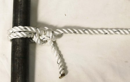

Hmmm .... so if time is not on your side.... can you run the line around the thimble and tie a knot at the backside of the thimble?
Something like this....

That looks like a halyard knot tied around a thimble, interesting.

i've seen thimbles spliced in, but never one like the halyard knot / thimble assembly. does the knot keep the line going around the outside of the thimble taut enough to keep the line from falling off the thimble under load ?

Just consider the damage that thimble can do to the rope if it comes loose and the ends dig into the rope. I've seen ropes seriously cut. Thus, there is no way I would consider a knot with a thimble safer. Only if spliced very tightly, and ONLY if a proper rope thimble, not a cable thimble, is used. No sharp corners.

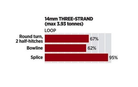

Strength in percentage of maximum load.
So, if you cannot splice the line to form a loop, some people would say (as T-Bird did) use the round turn and two half-hitches for a mooring.
If using Marlowbraid, the round turn's strength is 71% of maximum load versus 47% for the bowline.
http://www.yachtingmonthly.com/sailing-skills/strongest-sailing-knot-30247

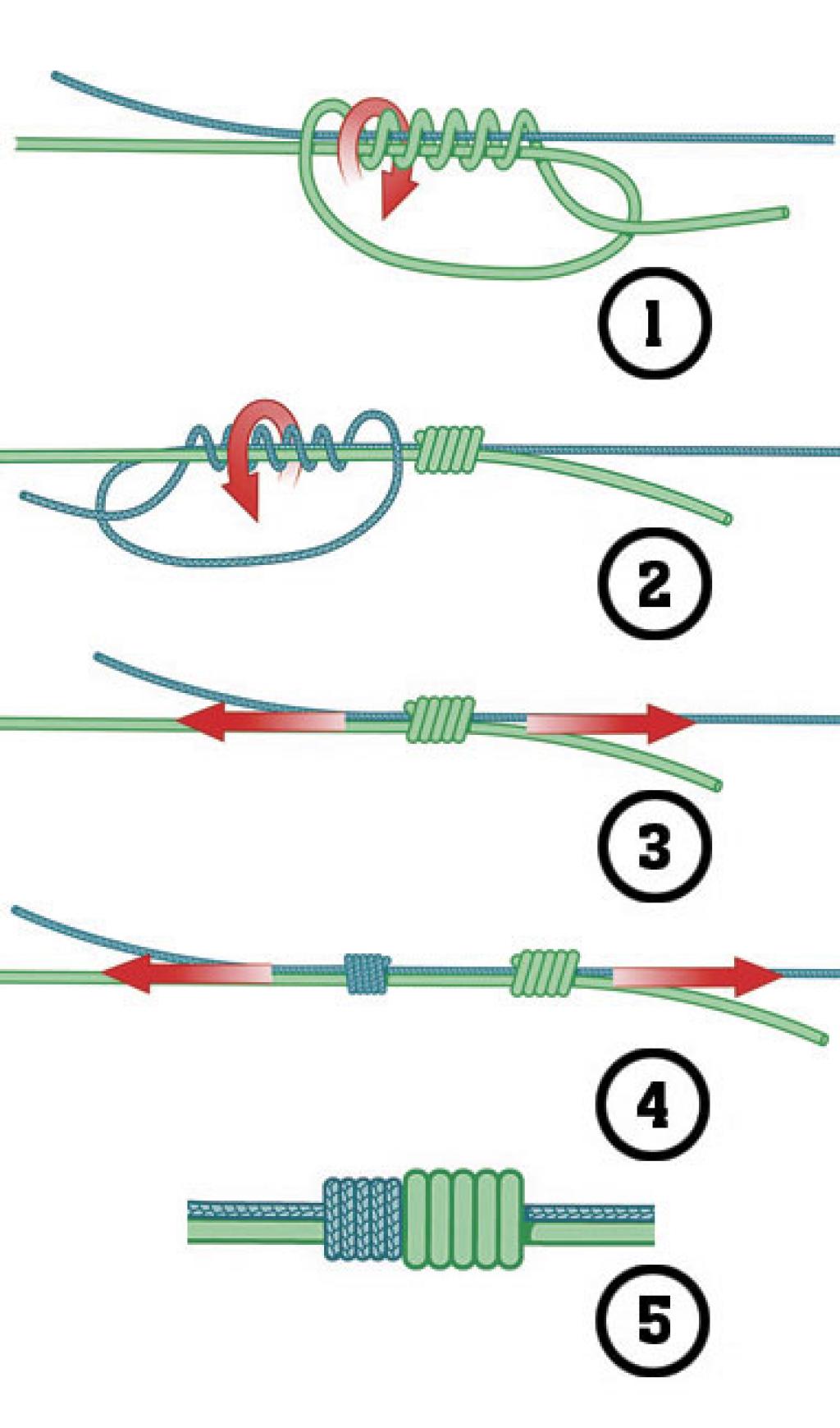

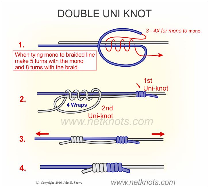

For Hurricane Irma I ended up having to tie splice some of my shorter lines together to get the length to reach across the canal. I was working with my son who is an avid fisherman, and he spliced two of the lines together using his favorite fishing knot for tying on fishing leader. a Double Uniknot. It was a gorgeous splice knot, but I don't know how strong this is with 3 strand nylon or nylon double braid. The knot survived the storm, but now I cannot get it undone, and may have to cut it off.

Double or triple sheet bend to join two lines; normally one line may be a bit larger than the other.

Chip... get out the knife and separate those lines. The UniKnot is a great knot. It maintains the strength of the lines but it locks up and there is likely no way to undue it after the storm pulling it tight. Fishing we just cut the knot and pull out more leader. You will not want to try to save that part of the line involved in the knot as it will no longer have the same strength as the remainder of your line. You may want to be suspect of all the line used to tie up in the storm. Depending on the conditions you experienced, I suspect the line strength will be impacted by the storm experience. The pulling on line breaks the line down. Repetitive pulling as in holding a boat to a dock in a storm will heat the line and break down the fibers. I would not throw the line away, just not use it in critical situations.
But how much strength do you think the uni Knot cost on nylon dockline.? Is it stronger or weaker than a double/tripple bend knot for this use?
22,766
I have never seen a knot test of the two comparing strength on double braid or nylon 3 strand lines.
I know that on fishing gear using single strand nylon (monofilament) that the uniknot is used because it is stronger than several half hitches. Each knot bend/bite (half hitches are multiple bend/bites on the line) contributes to weakening the monofilament. The uniknot uses wraps not bites so is suggested to be stronger on monofilament.
