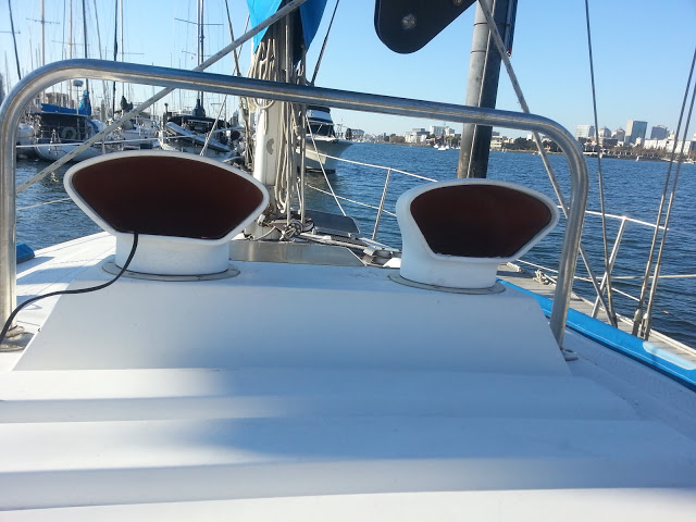

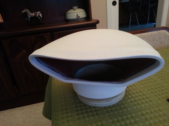

Mark,
How timely. I just painted one of mine here at home yesterday. I am using Rust-Oleum Flexidip Removable Rubber Coating. Except, I am not going to remove it. Its very flexible. Four coats. I bought it in Home Depot.
Previously, I used a vinyl paint available from Kragen's (now O'Reilly). That was ok, but it wasn't as flexible as this new stuff seems to be. I did find it was completely removed when I wiped the cowl down with an acetone soaked rag. That got all the black stuff off inside as well, so the red interior looks ok.
The original white skin layer on the rubber cowls is cracked (and has been). That telegraphed through to the vinyl paint I used earlier but they still looked ok for a few years. Following a good sanding with some 180 grit paper, this rubber paint mostly filled the cracks. As I deflect the cowl it seems to stretch and not break again. Adhesion seems good. But, then I only painted yesterday afternoon, so its not been the recommended 24 hours dry time. I'll leave it out in the sun again today to bake.
I can't say how easy it is going to be clean in the future, but as long as its not heavily abraded it should be ok.
Good luck.

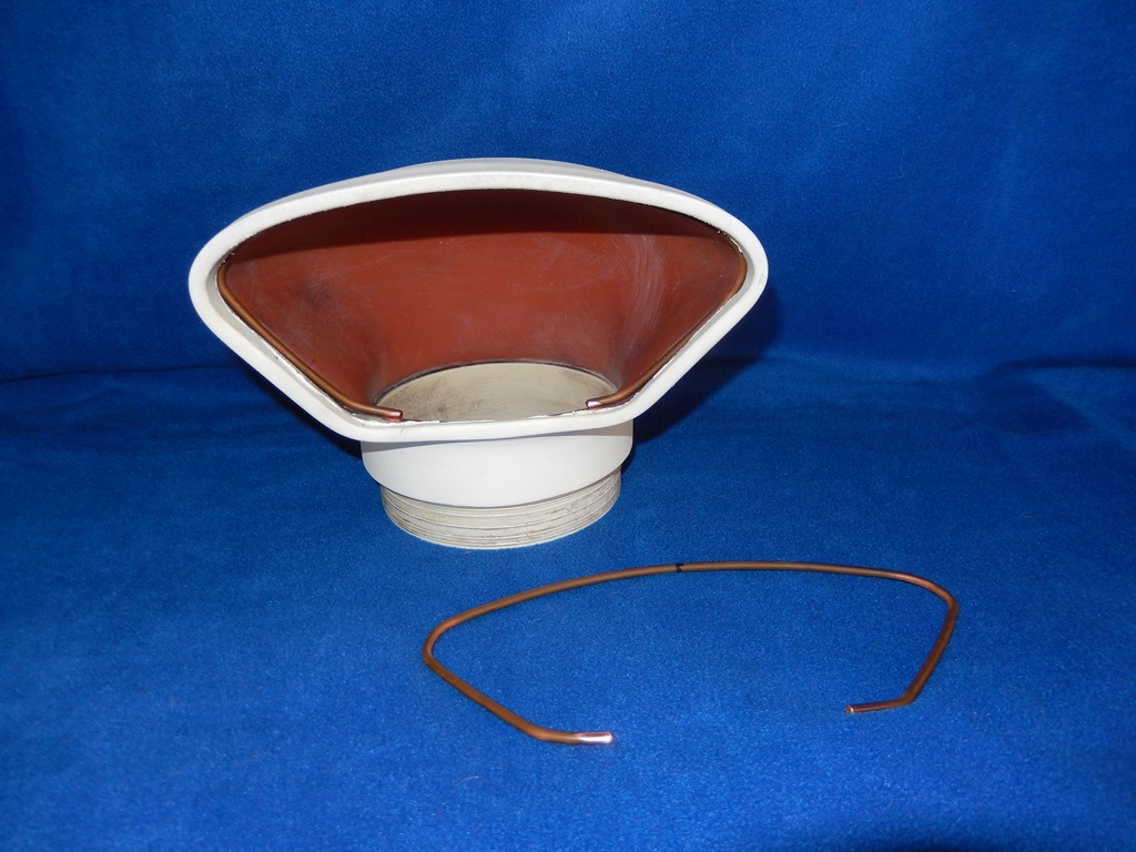

Hunter 1983 Hunter 34 South Pender Island
Notice, as with my cowls, that yours are not holding a nice shape. I noticed a recessed line inside the opening of my cowls and decided they needed a support bracket. Fond a heavy piece of copper wire about 1/8 inch in diameter and formed a shape with it so that it just fit within the inner recess. Now, I'm most impressed with the shape of the opening and it won't flex as easily now in the wind.

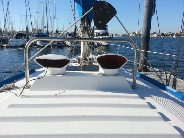

1,665
Hunter 34 Alameda CA
Forever Faithful, I took your suggestion and made my own copper frames for the cowl vents after I finished painting my second one this past week. They look great now. Thanks again for the tip.
