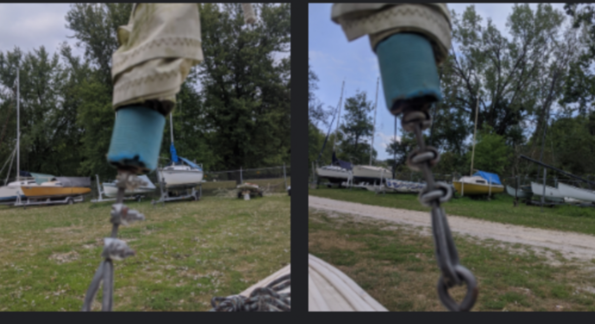

This roller furler was installed on my Siracco 15 when I brought it. It works fine but has no furling line attached. I don't really see how it would work. Are there broken/missing parts here?

I don't see a drum for a furling line. I should imagine it would go on the blue piece or a piece below the blue piece that was cut off by the upper cable clamp.

The furling line wraps around the drum, I assume? That is what I was thinking. There's no good way for the furling line to wind around this thing.

Im not sure that can be called a furler. Normally, the cable would be swaged, not held together with industrial cable clamps? Are those even stainless?
13,078
That looks like someone's "better idea". :confused:
It looks like the prior owner just wrapped the sail around the forestay.
The bulldog clamps are an unconventional way of securing standing rigging on a small sailboat.

I agree... the "chain plate" looks like a simple eye bolt from lowes..

I’ve seen thousands of furlers, literally, and I’ve never seen anything like this home-made contraption. I don’t see how it could work. The forestay assembly assembly looks like an accident waiting to happen. You should replace hardware store forestay with something more conventional.

by that statement I mean that the sheets pull through the blocks and back to the cabin and the sail can catch the wind. The issue is that when I'm done using it, I have to walk up to the bow of the boat to manually furl it. That's why I would like to get a furling line installed.

After seeing the bottom of the furling tube, I thought someone had cut the tube with a blowtorch. Close inspection, it looks better than a cut. Maybe someone just stole the drum? Does anyone recognize this lower end of the tube that would have seated in the drum... somehow???

Does the sail slide into a groove on the furler, or attached with hanks through slots in the tube?
I'm gonna roll the dice and speculate that when the P.O. replaced the forestay with the 3 clamp job he found the drum wouldn't fit anymore so he removed it. The furling drum is simple and you can fabricobble something yourself. Search for PVC furling for examples. PVC Roller Furler
Roller furling it's very low load intended for 2 positions: all in or all out. Roller reefing operates in between and sees higher loads.

Id still be far more concerned about the integrity of the rig, as adversed to the ability to furl. That wire, and those 89cent clamps are all thats keeping the mast from coming to sit with you.
7,653
I can't process what I am seeing. It's a 15 foot boat -right? Couldn't you get a piece of stainless wire and make a cleaner install. How does the sail attach to the forestay? I can't see any evidence of a foil. Or is there wire sewn into the luff of the sail?
It's a really small jib on that fractional rig. You could easily handle it without a furler if you don't want to spend the money for one. You'd need about 15' of wire, 2 swages, a tack fitting, and a turnbuckle. These are examples for purpose of estimating expense not recommendations:
