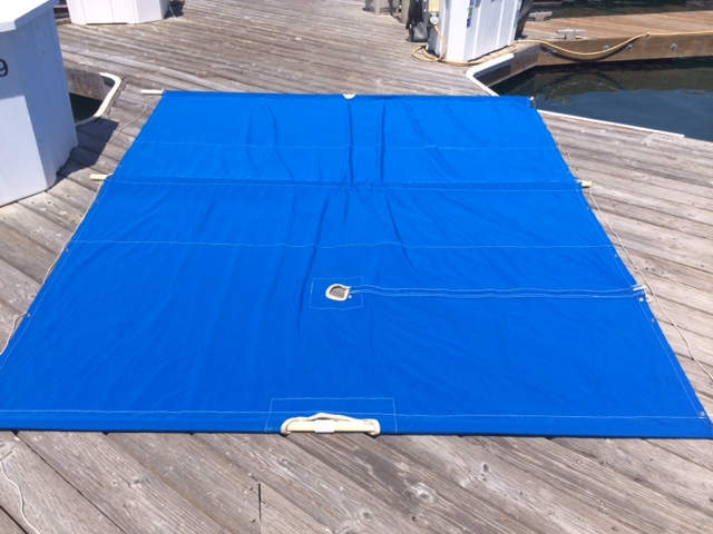

Hi! So, we were going through all of the canvas that our MkII came with, and there's one thing we just can't figure out what its for...
One of the sets of canvas is a cockpit awning cover/dodger extension, similar to the one in this picture:
http://www.charterworld.com/images/yachts/catalina30.jpg
So, this next one is a mystery!
We just can't figure out what this is supposed to do? It has a zippered hole to one side and some very specifically trimmed pieces on either end. It doesn't have any snaps or buttons, just the grommets in the corners, and there's three PVC poles that go in it. It tapers wider on one end. Any ideas?????

looks like a fore deck awning, maybe? The forestay would pass through the zippered hole, the PVC poles fore and aft to hold it open and tie the forward PVC to the pulpit and hold it all up with the Spinnaker halyard attached to the aft pvc pole?
Apr 8, 2010
1,606
Frers 33 41426 Westport, CT
I've seen that before on a J/109, the main halyard (while clipped of on the end of the boom) goes through the zipperd opening, the closer end of PVC gets tied to the backstay, and the farther piece gets tied to something forward with the PVC resting on top of the boom.
It's a race boat temporary bimini.

FourPoints, I think you're right and that's exactly what it is.
The dodger extension canvas we already have is fine for shade in the cockpit, and I don't see a huge need for this piece of canvas. My wife really wants a fore-deck canopy, so maybe I'll just turn this into something else.

If you decide to do any racing, particularly extended or distance racing, then you'll probably regret not having this piece. The idea is when doing a race you take off the bimini / dodger and leave them behind (to save the weight of all that metal, if nothing for the windage), but keep this onboard since it's very light. When you get to the dock at the end of the distance race, or at the end of the day of a multi-day race, you put this up and have some shade. I've also used them on days when you're out there for several hours under postponement waiting for the wind to build before a race, and put one of these up, It once prevented a crew mutiny...
