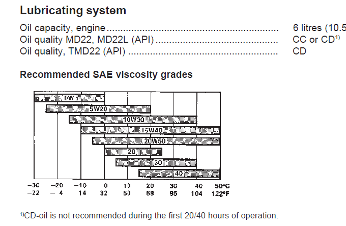

Maker of your engine provided the desired viscosity (SAE weight) as shown in Rich's first post ( my engine is same year and model as his)
If you look at his chart, 10W30 would be the best viscosity range for OUR recreational outside temperatures.
American Petroleum Institue (API) has made the standards for blending Oils to achieve the Range. 10 would be better in Cold and 40 would be better when hot.
