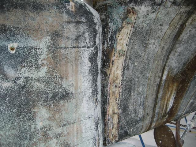

I just pulled my Hunter 37c for a paint job and found a missing part.
Something is missing at the rear of my hull. There is a small indentation in the fiberglass just before the tiller. There are 5 stailness screws in the hull as if something was atached there. Same thing on the port side.
Does any one knows what it should be??
Thanks

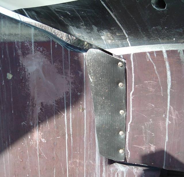

Sandpiper remembers correctly. I did fill that void. The fiberglass is suprisingly thin back there and those screws had better be tight and well sealed. I carved some wood, a couple of 2 x 3's, to fit. Then I mixed some epoxy putty and poured down in there. A terrible place to work under the radial wheel and deep down.
In the picture you can see that I had replaced mine. These were cut from stiff rubber stair treads. I have since removed them and glassed the holes over.

Thanks all. I did go back to the storage trailer were I had stored all the boats's articles and indeed found 2 grey plastic flaps. The holes for the screws were ripped however the holes did match up the screws on the hull. I would have never guessed the use or need for this flimsy factory fix.
I too will glass over this area. I am fixing some dock rash at this time and preparing for a new paint job.
