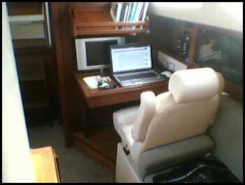

I'm now finally living on Fred V, albeit on stands in the marina parking lot, and every night find myself staring at the nav station and hoping for some inspiration. Since none is coming, I thought I'd better turn to the forum.
I'd like to convert the current configuration into a combination nav station and work desk. For work, I'll need a place to put my laptop, space for a 19"-22" flat panel monitor, and some comfortable stool I can stow when I'm not sitting on it. I'll also need room for the electrical panel(s), VHF radio, and stereo. But what I don't know is what other items, i.e. nav instruments, I should consider installing.
I've pulled out the 6 original instruments (VHF, ham radio, and 4 COMBI units, half of which I have no clue what they did!) and am scratching my head wondering what I should replace them with, if anything. Since I'd like the engine and GPS instruments to be installed on the cockpit pedestal behind the compass, I'm thinking whatever instruments I have in the nav station will just be to help with chart work or as backups. I'll have a compass and portable GPS in the cabin, of course, but just can't figure out what more might be needed.
Any and all ideas and suggestions would be most appreciated. Also, if anyone has advice on which type, brand, and/or model of instrument panel to install on the pedestal, I'm all ears!

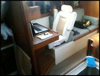

I too put the gps and chartplotter at the helm, and down below, I end up either watching tv or on the pc because I'm at the dock. I don't do well down below at night trying to stand on my head reading a chart with a red light in 10 ft seas, oh no, that will last only a short time, guarunte'ed. I'm exaggerating a little of course, but this was my office for over a year, and I'm hoping that it will be again some day. I put the main VHF down below, and the command mic up in the cockpit. The same with the stereo, so far everything's a go. Chair's holding up and adding the tool box raising the floor was necessary. Maybe a gps readout down below for doing log books, but beyond that, maybe a radar? That's beyond my finances right now.
