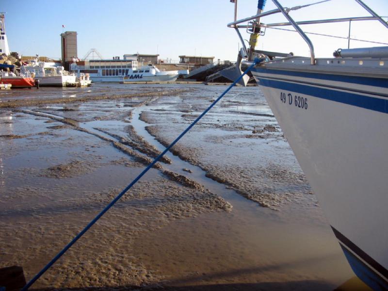

I frequently sail my 34 down the lower St.Lawrence river where the tides can be as much as 16 feet ! Several marinas dry up at low tide and of course you have to time your arrival in and out. I draw 4'3" and the first picture (#2379) shows the track made by the keel as I backed into the slip with barely enough water left in the marina. The second picture (#0001) shows the prop and rudder and the last one (#0010) shows the boat with dock lines slack as boat rides higher in mud than water ! Soft mud so it's no problem as time to float back the boat stretches over all the hourly tidal range and breaks the vacuum created by the mud. Need to close all through-hulls to be on safe side. Hate to think of what a wing-keel would do !
