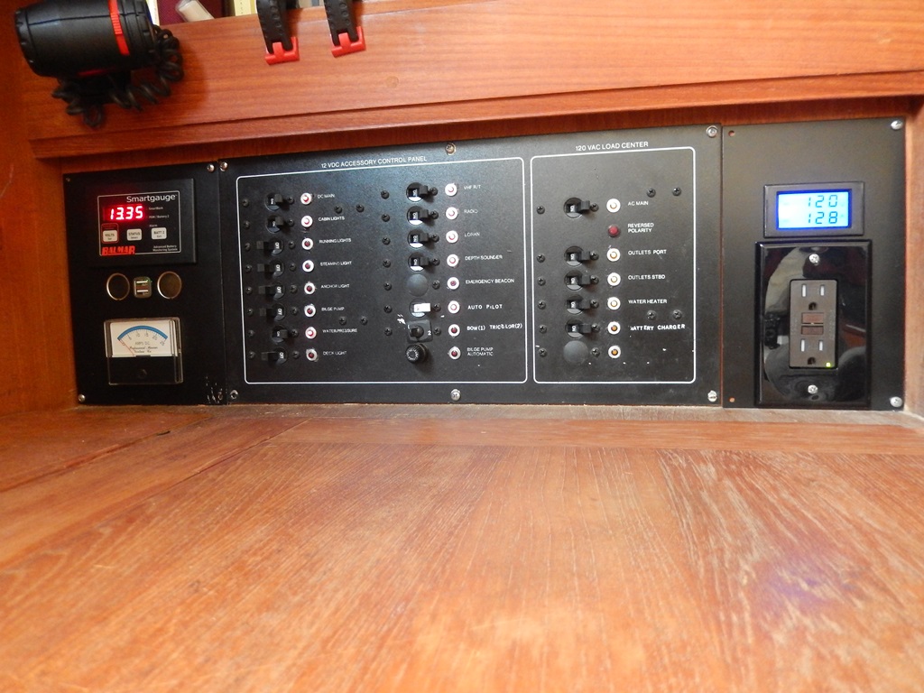

All good points with regard to engine gauges. I'm basically interested in the meters that might be useful on my new electrical panel. I think I have it covered with the battery monitor and tank gauges. I think I will install a pair of USB ports in that location as well. It sounds like volt meters and ammeters are mostly for decoration.
14,002
You may want to rethink the USB ports and install old school 12v "cigarette lighter" ports. Over the past few years the power demands from USB have steadily increased, iPads need more power to charge than iPhones. If you commit to a now current USB port you're stuck if power demands increase or if there is a shift to USB C. With old school plugs all you need to replace is the adapter, quicker and probably cheaper.

On my bluesea panel I have digital
  1. AC voltage
  2. AC amps
  3. AC wattage
  4. AC frequency
  1. D.C. Voltage 1
  2. D.C. Voltage 2
  3. D.C. Voltage 3
  4. D.C. Amp 2
I've used all but frequency and wattage. I think there is som alarms in there but never used them​

I would agree with the usb plugs. We have a BlueSea dual outlet at the power panel and a BlueSea outside version at the helm. All of my camera gear is now usb in one form or another, and making yourself scarce at work is so much more comfortable when you know that you can get on a call and not drain the phone. There's so much less call these days for the cigarette lighter plug.
We're hearing that cars are moving toward the new 24 volt standard. Here we go again....
