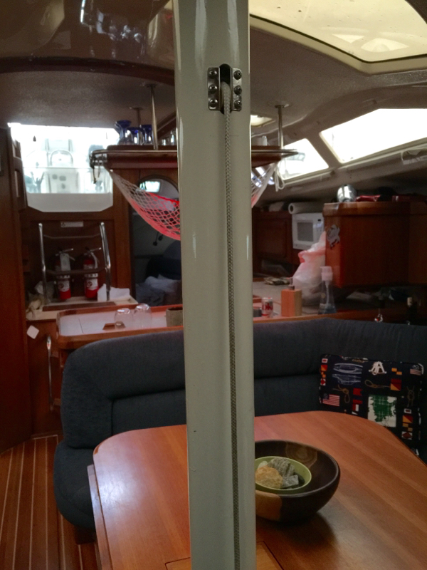

I am sure someone knows what this line does. It's is on the compression post above the table. Assume this has something to do with lowering/lifting the table but it hasn't done anything for me for that purpose. I definitely feel a weight when I pull.

Dumb waiter from the galley below. Don't all sailboats have that?

Did not have one on my Catalina. Well that's what I thought it was. Not working tho. That's km pretty easy to move the table up and down. Thanks all

We own a 40.5 for the past 5 years. The rope is a sash cord counter weight so you car lower the table for a queen size bunk. If you own the filler (storage) The table was frozen to the compression post and wd40 or p bolster wouldn't free it. Enter Kroil . Twenty minutes and free. Table turned into a pita. Ended up making new one and new leaves like an 88 37.5. Didn't want company in those numbers anyway

The weight will clunk heeling or sleeping. A threaded hole with cap screw about 2 in horizontally against the weight will stop that . About ten in above floor

If yours is like mine, inside the little insert on the table is a chrome handle. Turn it to loosen or tighten the table. That should regulate the counterweight already mentioned.

thanks david. I tried that already. Never had a problem lifting and lowering but I get how it works now.
