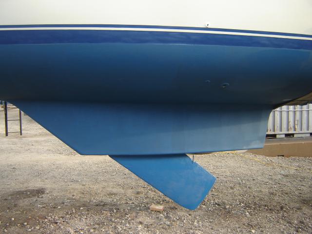

RECESS
Dec 20, 2003
1,509
Catalina 27 . St. Mary's Georgia
This is from when I was doing a blister repair on the CB but you can see how the pendant attaches to the CB with the shackle.

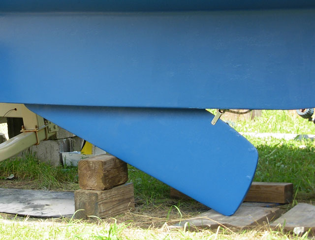

Oct 21, 2005
205
Oday 26 Indian Cove, Guilford, CT LIS
Here is a photo of the pendant attachment on my 26. As Joe said, he has some great pictures of the other parts. Never say never, but it is HIGHLY unlikely the cb would fall out if the line broke. If the parts were that worn, it would fall out whether the line was attached or not, IMHO.
