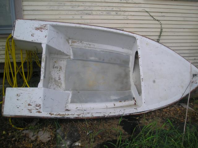

What do you think of this dinghy design?

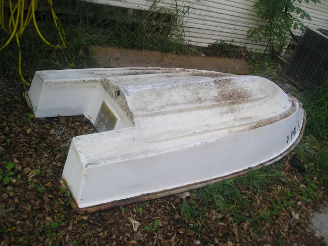

I have never seen one designed like that. Is moving the engine forward an attempt to help it plane easier? The listing says 9'. It also said it started as a hard bottom dinghy and has been added to.
I wanted one less than 8'. Is chopping those transom extensions off an option, or will it ruin the preformace of the hull?
Is it just me or from the top view, does this look like the front half of a boat?

I'm no naval architect, but chopping off those extensions, I think, would have a big effect on stability both at slow and fast speeds. Those extension look to be about 20% of the length. I would think that it would make it far less stable when boarding with those gone.

I am a naval architect. This not half bad idea if you are not trying to maximize interior space. Unless the picture is distorting things, it was built in the mold for a longer boat by inserting mold parts for the transom and stern sponsons. If you cut the sponsons off, you would have a boat of much less capacity and stability. It might not be worse than a lot of small dinghies out there but the high deadrise from being essentially the bow of a larger boat might make it pretty tiddly. I'd use it as it is or pass it on to someone who can use it in it's present configuration.

Short?????
Why would you want so small,I had a 8' infaltable and sold it for a 9'6''.
The 8 ft was really OK but we want ed a little more room,plus like already said I think you will not be happy with satability.

In either case, it's pretty ugly... I'd pass on it.. :) Dinghies are small enough as it is, and getting one that guts the interior space like that makes it far less useful in most situations.

Looks like an oddball to me. I`d pass nad get something more conventional.

I had an inflatable with a similar configuration. It would NOT maneuver in tight. When the OB is turned sharply, it is working against the hull section and just washes out. Took a lot of planning and jockeying around to dock.

Let this one pass by. There are many dinghies for sale. Wait until you find the 8' you are looking for.

Every boat is designed to serve one major purpose. This design is not the best for a sailboat dink. The design is optimized to carry a heavier engine and bow is covered to keep things dry in heavy chop or perhaps spray. I would say it was designed for fast transport for one or two persons. I think I have seen a boat like that in the past but can't recall where. Images of two kids racing up and down a bay come to mind.

This one is probably going to be too heavy for what I want. I want to be able to pull it up and keep it one the foredeck. I tried to edit this post but messed up some how. This is exactly what the ad said:
"started as a hard bottom inflatable but the sides have been extended and the back has had som added to"

Probably designed to fit AROUND a mast when inverted on a coachroof, etc. Good idea if that was the original concept, despite the probable handling problems.
Id pass on this one and get a proper dinghy ... unless you dont have much J dimension on your boat.
