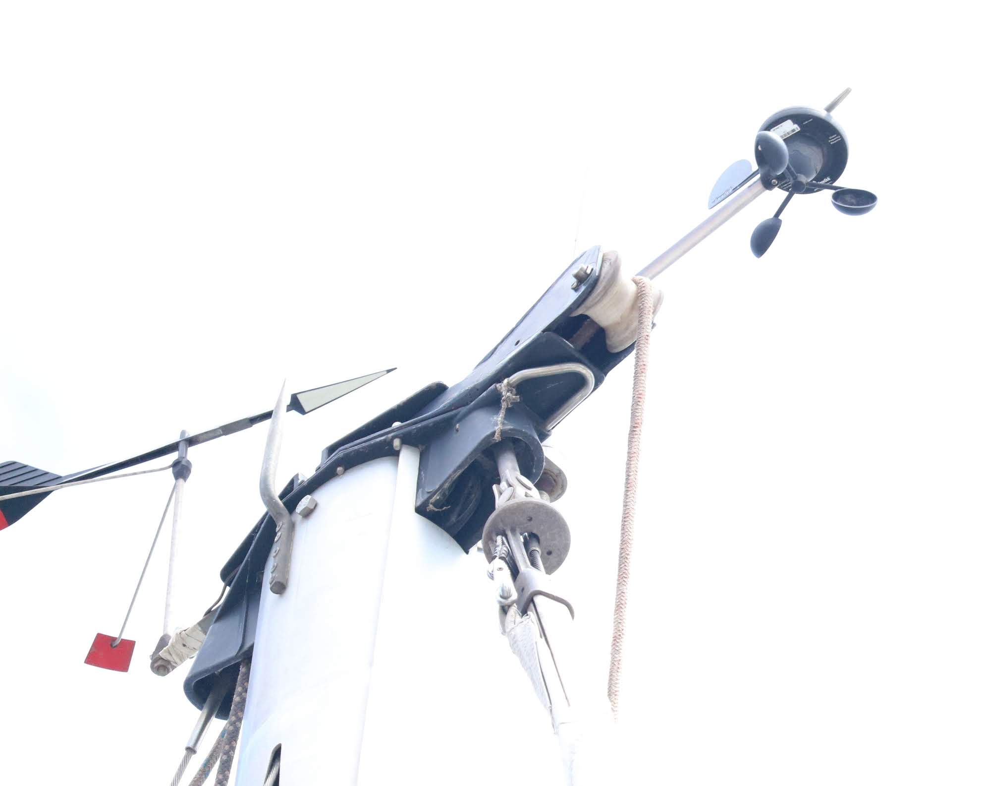

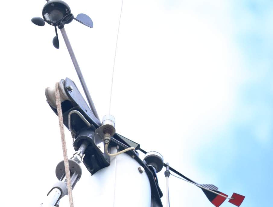

I dont have a good top view, but here the top of my mast:
- Windex
- Windex light
- Wind vane
- Anchor light
- VHF antenna
Lines include Main halyard, spin halyard, topping lift. My furler (CDI) has an internal wire halyard.
F2D2DB66-F6A5-48D3-885F-DA8E2E8840CA.jpeg 61C8C7F6-A315-4725-8B83-2969C0B23352.jpeg

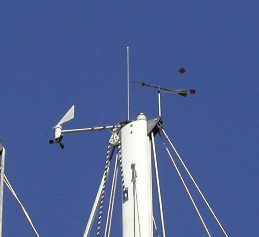

The basics here, windex, Wind instruments, VHF antenna, anchor light. For lines, port and starboard jib halyards, Spin halyard, main halyard and topping lift attachment.
