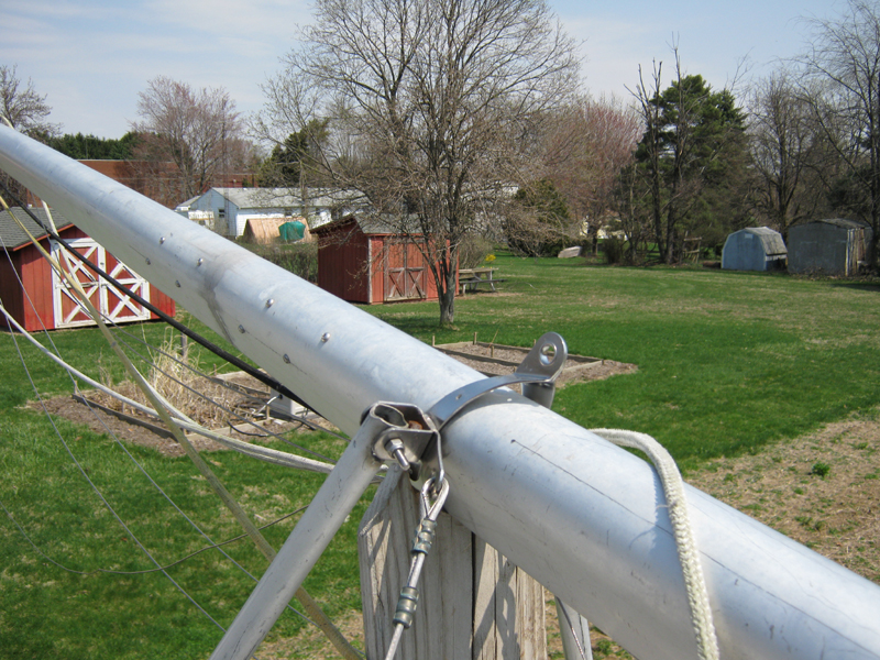

Sorry for your bad luck...at least nobody got hurt. You might look into having your mast repaired. My boat was converted by a PO into a tall rig, with a 30' tall mast, by splicing two shorter masts together just above the spreader. There appears to be an internal sleeve which both halves are screwed to with a surface weld to finish it off.
I was a bit dubious about it when I bought the boat, but I've sailed her hard for two years now with no issues. Might be worth researching before you replace the entire mast.
