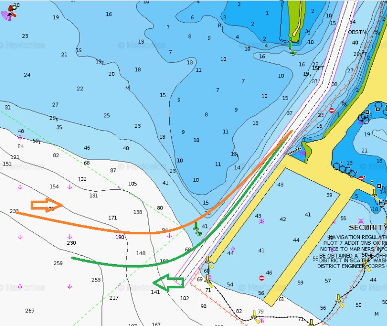

My marina has a fairly lengthy entrance/exit that requires going first between an island and the shore. After the end of the island there is a distance that many if not most boaters cut especially when it is not low tide. There is a green marker at the very end of the maintained channel that I always pass on my way in and my way out(to starboard on the way out, to port on the way in). It can be a bit odd as a bunch of small fishing boats and similar cut the mark coming in but they usually give plenty of space so it is no big deal.
Recently as I was leaving and nearing the mark a medium sized(40ish foot) motorboat was on the way in. I recognized that we were near a collision course from a long ways off but also recognized that he was cutting the corner, albeit not by much. I initially held my course thinking he would navigate around the mark but he held his course. Eventually as I neared the mark I steered to port to make it obvious that I was changing course away from him, but also with limited room between myself and a large breakwater I didn't have a tonof space. We never came that close as neither of us adjusted our throttle and I was the only one to change course, but it was still awkward. As he passed the mark to his starboard he stepped out of his wheelhouse and shook his finger(not THAT finger... he was scolding me) at me and yelled something.
In an ideal world I realize I would have turned to starboard to pass on the correct side, but that would have taken me out of the channel. I happened to receive a GoPro for a gift recently and had it on the boat for the day. I went back and watched the footage and confirmed what I remembered which is while he was not cutting the corner by much, the motor boat was never on a course to keep the mark to his port.
I realize this is a lot of words, so a photo is attached. My rough track is green and his is orange.
Did I do something wrong? Was he scolding me for not wearing my life jacket(though he was also not wearing his?) At first I thought maybe he reached out over VHF and I had forgot to turn mine on, but I checked and it was on and on channel 16. If I am doing something stupid I definitely want to know as this is how I get in and out every time I leave/return to my marina.

Based on your description and the image you posted, no.
You were correct to make the limited adjustment to port to allow for a stbd-stbd passage.
ColRegs Rule 14 governs meeting or head-on situations and states that “when two power-driven vessels are meeting on reciprocal or nearly reciprocal courses so as to involve risk of collision, each shall alter her course to starboard so that each shall pass on the port side of the other.”
I don't recall where it's written that the vessels can pass stbd-stbd by mutual agreement.

I think you did the right thing given the layout of the channel and your initial reaction to follow your course, then alter when needed.
From the powerboater’s perspective he may have just been disregarding the channel entirely, and figuring he was the stand-on vessel being on your starboard bow, so he would’ve expected you to turn to starboard and pass astern of him. Doesn’t make him right - the restriction of the channel is a good reason not to do that, but it would at least explain his misguided reaction.

You were in the channel, he was crossing, so that potentially makes you stand-on to crossing traffic (Rule 9). However, based on the chart you posted, there was lots of deep water on the starboard side of the channel, so you were not restricted from turning to starboard. You should have followed the far right side of the channel, moving even farther right if need be. You were not restricted, so rule 9 does not apply to either vessel.

He was to starboard, which makes him stand on. He would expect you to alter course to starboard, NOT to port.
Altering course to port is generally a BIG mistake, particularly in near head-on situations, since the required dodge for BOTH vessels is to turn to starboard. Turing to port invites a head-on collision.
Sounding a single blast, confirming port-to-port is good. He could reply with a single horn.

So yes, what you did was backwards and potentially hazardous. COLREGS is not about politeness, it is about doing what is predictable. As a rule, turn right unless the other vessels is over your right shoulder. If you did not feel you could turn right (which you could), you could also have just slowed down and waited for him to pass ahead. That is not wrong in this situation.
23,390
Local knowledge, the area to the west of the channel, on Colby’s starboard side is shoaled. That is why Colby was headed to the green buoy, before turning to starboard and out into safe water. The channel is dredged every couple of years. The river sediments are deposited on the west side of the channel between the island and the green buoy.

You are going maybe 6 knots at most, maybe less, right? And a powerboat is coming towards you, obviously not intending to heed any channel markers and probably at a speed greater than yours, making a wake, no doubt. So, you find yourself being scolded by a powerboater who probably thinks of a sailboat as nothing more than a slow-moving nuisance interfering with his intentions. Not always, but that's how many powerboaters think about blowboats. They just want you to stay out of their way because you move too slow. Your intention was clear ... you were heeding the channel markers and he wasn't. Don't sweat it. We can wag our fingers at all the nav rules in the books but the only one that really matters for recreational boaters is "avoid the collision". If the guy can't avoid another boat plodding along at 6 knots or slower in a (clearly marked) channel, he's the one with a problem!
OK.
One problem here is that the other vessel may not have considered the channel shoaling and thus rule 9. Heeding the channel markers alone, however, creates no special rights. For example, the Chesapeake Bay ship channel is marked, and there is generally > 20 feet on both sides for miles, so the markers are not relevant to recreational boaters and recreational boaters are not in a narrow channel. Was the OP as far to the right as possible, even if slightly outside the straight line to the mark? Just 50 feet may be all he needed.
Even so, turning to port is a big no-no when head-on or nearly so. You stay as close to the starboard side as possible. Get on the horn. Slow down. But I believe turning left in this situation is asking for a broadside and is ONLY permitted either very early (the OP's case) or in extremis, when you believe that action by the other vessel will not be enough. If the OP turned sufficiently early, then the power boat, who is not concerned about the channel, has nothing to complain about. What is "sufficiently early" is not always simple.
My point is to be very wary about left turns. COLREGS does not recommend them, people don't expect them in forward quarter meetings, and it would be likely you would be held responsible. The early turn violated both rule 14 and rule 15. The power boater may very well have been planning to go around to starboard at the last moment. Not a great plan by him, but not unusual either.
Based on the description and the diagram, they weren't approaching head on ... not even close to it (the path seems to show that they were approaching at almost a right angle). It seemed to be clear that the approaching powerboat was simply cutting a corner into the channel. @colb218 was simply making a slight adjustment to port to give the guy more room. It sounds like speeds were relatively slow, distances were adequately safe, and colb's intent and adjustment was abundantly clear so it simply makes no sense that the guy in the powerboat should be giving him a hard time. Your statement that the guy has nothing to complain about seems to be about the only thing that applies in this instance.

I'm guessing in your situation the power boater had no idea you had a keel, or had any sort of issues with shallow water, because he didn't, so why would anyone else.
This is most likely the case.

The power boat may have made the assumption the sailboat could safely navigate outside of the fairway. If I was the power boat, I would not make that assumption. The power boat did not hold his course, he continued to alter course to port. I don't think he was in any position to wag a finger at anyone.
My vote is @colb218 made the prudent choice. Stay out of the way, make early and clear actions that show your intent. Sounding two signals would have made it better.

While the drawing shows the paths of the two boats it does not indicate where each one was at different times. The green track does not indicate any turn to Port. In race protest situations it helps to make a drawing and label the boats involved, like Port 1, Port 2, Port 3 and Starboard 1, Starboard 2, Starboard 3, etc. This helps to show the relative positions of the boats in "snapshots" to the Protest Committee. Doing this with the drawing would help people understand exactly what happened, and when it happened. Position 1 might be when Colb first noticed the powerboat on an almost collision course. Position 2 when he realized that the powerboat wasn't changing course. Position 3 when Colb changed course (and show the course change in the track), and Position 4 would be when the powerboater wagged his finger. There are people on the road who drive like this powerboater. They end up in the back end of ambulances because other people can't get out of their way fast enough. You were probably both lucky that YOU changed course.

What I was trying to indicate is that although the OP thought he made a prudent choice (and it worked out fine and the other guy was mostly pissy), unless the other fellow sees it the same way, had quarters been closer, perhaps not. The power boater would have expected a turn to starboard, he would have turned to starboard as he believes the rule requires, and the result would be a T-bone.
Yes, there is a marked channel, but rule says that this only manners if you cannot navigate outside the channel. You would probably end up having to prove with soundings that you would have run aground before completely the maneuver. That is what rule 17 implies. That you physically could not turn to starboard. It's a tough situation. But consider the case, in extremis, seconds before impact. If you turn right you may run aground in mud. If you turn left, and he turns left as required, you will get T-boned, your boat is a total loss, you will get charged, and someone may die. Better to run aground in mud. Stay to the right.
And THAT is how the court would see it. Really. Look up the case law, and you will find that the courts have found this way on crossings near channels a number of times. Turning to port in front of another boat requires a LOT of room.

If you turn left,
If you believe, based on local knowledge and charts that the you will be stuck in the mud and unable to maneuver then the Regs indicate you make an obvious directional change and you use a horn (two blasts) to indicate your direction and situation.
The oncoming boat seeing your directional change and hearing the horn blasts has been put on notice of the situation and returns the signal (two blast) to acknowledge the communication.
If there is no response from the oncoming “Crossing vessel” then immediately issue the 5 horn blasts and slow down. Continue the warning 5 horn blasts and maneuver to avoid a collision. This is spelled out in the Regs.
The regs do not indicate that you must turn your boat onto shoaling waters and run aground in order to pass starboard to starboard.
While the statement is true when both boats are bow to bow, turning to port when the on coming boat is already on your Starboard side is the shortest escape from a collision. Turning to Starboard in this case will take longer as you both must cross bows and if you run a ground in the process put you in greater danger.
