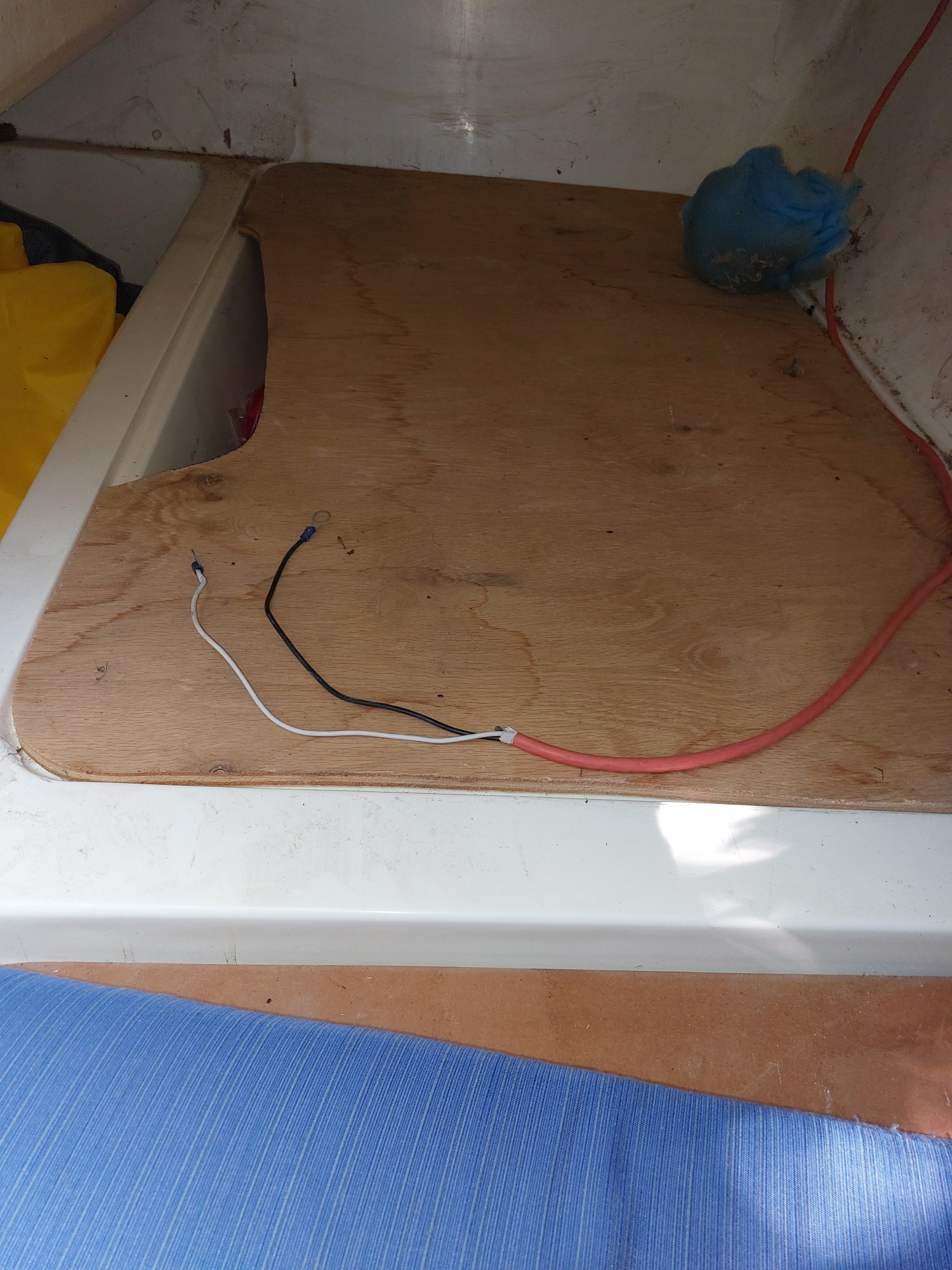

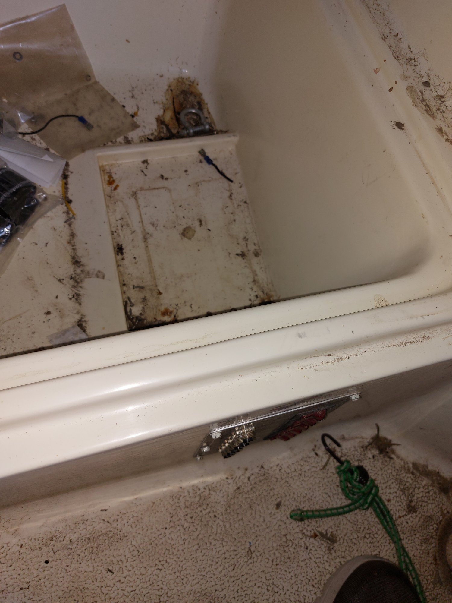

Going through a Merit 22, getting it ready to go back in the water. Since the boat has been sitting in storage for a long time there is no battery and no example of size and type to put in. Boat only has a single cabin light, running lights, AmFm and a bilge pump. Attached are the set up that was with the boat.... a space for a small battery that was unused and an modified cord with very small terminal connectors. Any ideas what would power well? Ever use one of those portable cells like a Jackery for boat power?

Most common sizes used are group 24, 27 or 31 measure your space, ypu'll probably want to use a battery box for FLA batteries or at a hold down for AGM. Boxes available on this site.

For those loads a deep cycle group 24 should be adequate. I'd measure that cutout and see how it compares to the size of a group 24 battery box. A couple other considerations:
- How will you recharge the battery?
- Those black and white wires are more the usual AC convention than DC. The cord itself might not be marine rated. It would be better to have marine rated cable sized appropriately for your loads, with a fuse within 7" of the battery terminal.
