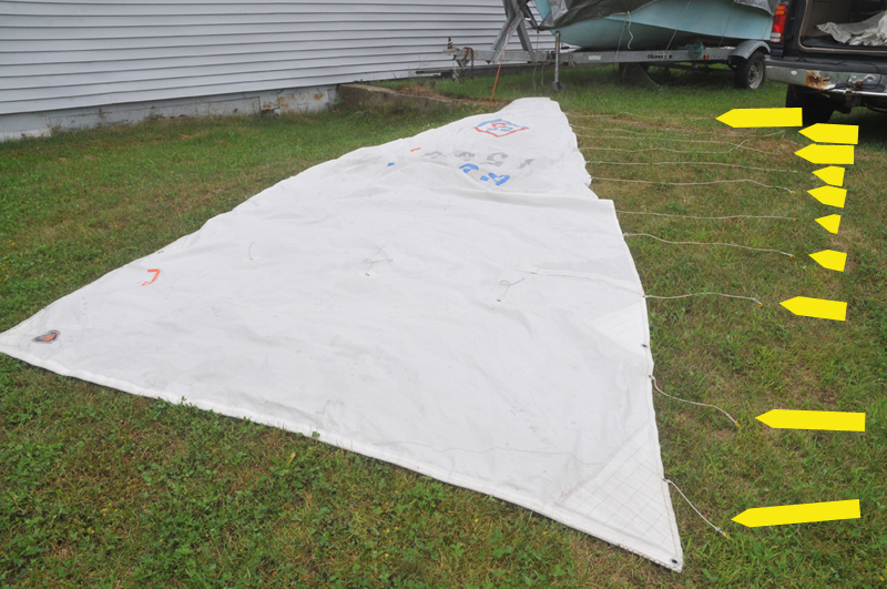

This is a sail off a Cal 22 , I think (box logo red on top, blue on bottom, "C22" in box).
It has different length lines coming off the leech, with rings on the ends of the lines. The leech has grommets all along it for the lines.
Any ideas? Never seen anything like it.... I'm thinking a shade of some sort.

It appears that those lines are positioned to attach to the topping lift, to assist in containing the sail when it is dropped. It seems though like they should be progressively longer At the head of the sail than at the clew. just a guess on my part. My neighbor has a similar setup on his O Day 34.

They are longer at the head. Seems like they would flop around beating the sail when it's raised.
