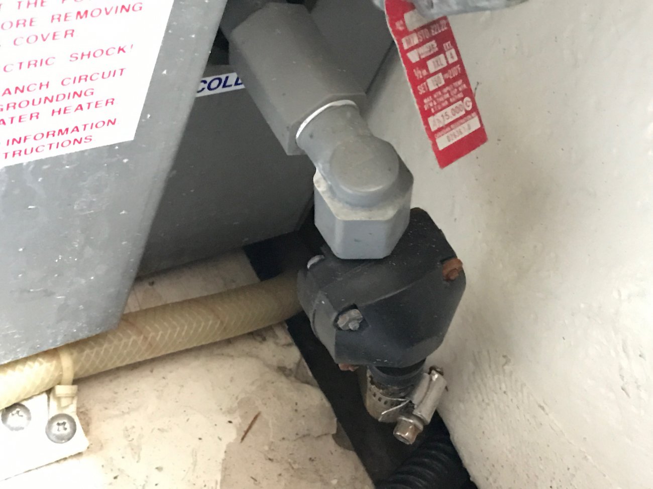

1993 C30 w/water heater.
I was looking at the water heater today. Getting ready to install a by pass kit.
I'm baffled by the gray fitting and black fitting on the cold water supply line.
I'm guessing the gray fitting is an extension and 90 elbow bit to looks a bit strange.
The black part? I've no idea.
Thanks

Never seen one like that but there should be a check valve on the input line. Keeps the hot water from backing up into the cold system. Maybe the black thing.
13,993
Probably, or should be a check valve. As @Capt jgw says it keeps hot water from backing up into the cold water system.
While you're taking things apart to winterize, make life easier next year. Replace the hose barbed fittings with SS supply lines from the hardware store. These are the ones that connect faucets to the plumbing system.

Though I have never seen one that looks like that, I'd also agree that it is a check valve.

What I particularly like about the black piece is they have turned it so that the screws face the water heater, so it cannot be disassembled in-place. Just one more half-turn and the screws would be accessible. As @NYSail said, a gift from your PO.

The black part I was told is a pressure regulator/check valve. I have one on my boat. Looks like the grey is the cold water input (high temp plastic??))
The pressure regulator/check valve is for when you hook up to shore water and is usually next to the input to the boat

A check valve makes sense.
I already have a hot water tempering valve on my list of spring projects. I'll add a new check valve to the list.

When the water is heated through the engine heat exchanger it will reach the engine's operating temperature, or about 160*. That temperature is below the threshold for the pressure relief valve to blow but hot enough to generate some pressure due to expansion. W/out the check valve that pressure will force hot water backwards through the system to the water tank. When someone opens a cold water valve they may get a blast of scalding water out of the faucet. The check valve prevents that from happening.
