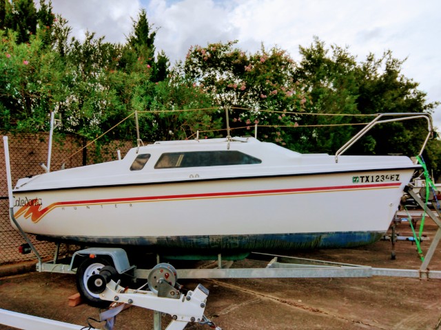

What adhesive did Hunter use to glue windows to the boat, the big windows on the sides of the deck.
Jul 5, 2020
10
Hunter 19-2 Nassau Bay, TX
I've got a 1993 Hunter 19-2. The top seal on the big side windows has come loose in several places and they leak in the tiniest sprinkle! Does anybody know what the black seal material is that they used to seal those windows on the 210, 240, and 260 series sailboats? The sealing compound is hard and no longer tacky in those areas. What have you done to fix that? Thanks, Jim B
