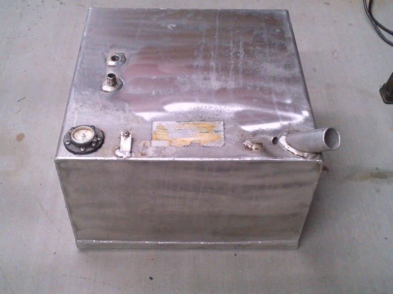

If that's not enough I noticed a little fuel in my bilge, I pulled the tank (what fun) only to find a small pin hole and some corrosion on the bottom of the tank. Priced a new replacement at Florida Marine Tank, $450 plus shipping and a month wait, too much and to long of a wait for me. Found a local guy that specializes in aluminum welding and tank repair. He cut 3 inches off the bottom of the tank, cleaned it out and welded on a new bottom.
