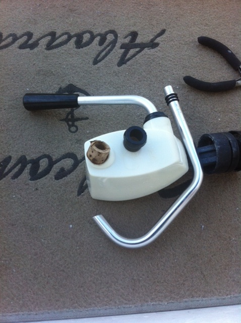

The boat has pressurized fresh water, but there is also a Whale Flipper galley pump MK IV GP0418. It's on the boat, so it should work. It's never worked since I owned the boat, so I cleaned it out, un-stuck everything, primed it, etc. Now it pumps.
The problem is that the outlet tube leaks at the outlet cap. So I removed the tube, and bought new O-rings (shown installed on the tube in the 3 grooves integral to the tube). The problem is that the new O-rings do not touch the inside of the pump housing. Huge gap, no seal. It looks like you would need very fat O-rings to cause a seal.
Also, the O-rings I found are nowhere near as big around as the ones in the Whale illustration (attached). In the illustration, it actually looks like the O-rings are big enough to go around the outlet cap. But that can’t be true, for then it would still leak on the inner part of the outlet cap where it contacts the tube.
Also, when I disassembled the pump, I found no Outlet O-rings in there, but a piece of cork instead (picture). I’m guessing this is why it leaks. There's no cork in the illustration.
Are the new O-rings supposed to be fat enough to fit inside the housing?

The picture I found of the Whale Flipper parts kit shows a cork ring.
Picture at this link-
http://www.westmarine.com/whale-pumps--whale-pumps-service-kits-parts--P011_331_003_004
Yep, there it is. Well I'll be.
Anyway, I found the thick O-rings at the hardware store this afternoon. Now no leaks at the tube, except for then the handle leaked, but amazingly one of the previous O-rings fit in the handle, so now no leaks at all.
Hopefully this thread will help another who takes apart a leaker Flipper pump. Thanks to all.
