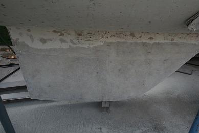

i am with you on the goggles and tyvek suit and mask sanding of the gelcoat down to the mate with 36 grit and random orbital ......

Wore out my good DeWalt orbital doing bottoms over the years. I attached my old shop vac to it when I was doing that. But now that I switched to an ablative no more serious sanding.

i am only doing this in order to make sure i dont have any voids in the glass and to be able to put on west systems barrier coat...going for about 4 to 6 coats of west with addative then on to bottom paint .......

Hat comes with the suit Bill. Did the barrier-coat in 1999. Good peace of mind. Wish the rest of the boat was as good as the hull.
