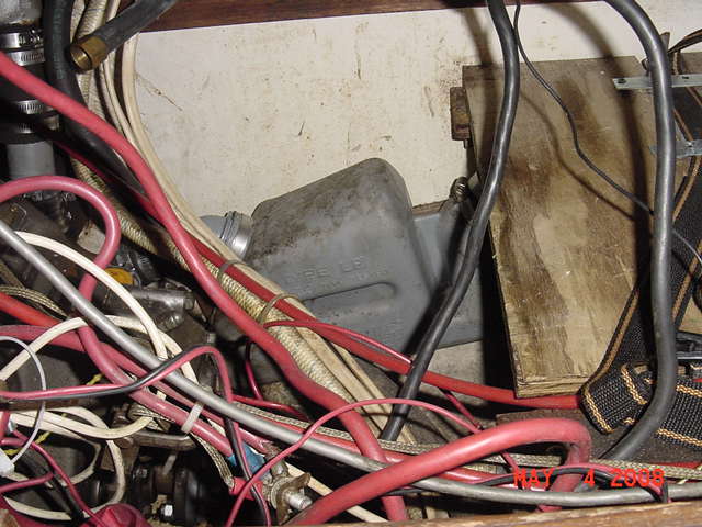

Any muffler that has the correct diameter will work. I installed a Vetus water lift in front of mine.
