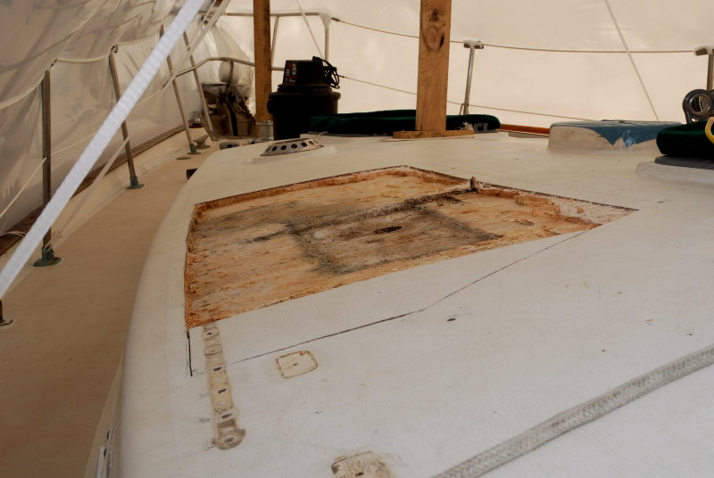

It is not uncommon for core to read wet and be wet but not yet brown or rotted. If the core got wet then the fittings were sealed it may not rot rapidly as rot generally requires some oxygen to speed the process. The problem with 30% plus readings is that they can sometimes go both ways. I've seen what looked like coffee grounds and nearly new and well adhered balsa all with the same reading. You can also get an area that is rotted next to one that looks like just damp balsa. Rot usually sounds out badly though and non rot but wet can still sound ok.
This whole section read 30% or better yet only the areas that are showing some brown were rotting. This stuff was still very, very well adhered to the skins in the non brownish areas...
