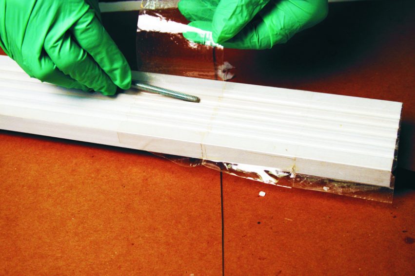

I have read about a method of drilling an oversize hole partially through the work surface then filling the hole with epoxy and putting in the screw before the epoxy is cured. Before inserting, the screw is coated with a mold release agent so the epoxy doesn't stick to the screw. The result is you have essentially molded in the female threads. This from a Gougeon Brothers technical advisor may explain it better than I can:
Fasteners and Hardware
When you want to install a threaded bolt or screw and be able to later remove the fastener, there are a couple of easy options. In our boat building class with the Saginaw Bay Community Sailing Association, we keep a wax toilet ring for on the workbench and stick a bunch of screws in it. We just pull these out as we need them. The wax gets in the threads and we can back the screw out easily after the epoxy has cured. You can also put automotive paste wax on a piece of cheesecloth, grab the threads firmly below the head, and back it out with a cordless drill in reverse. This applies a nice thin coat of wax evenly over the entire thread pattern.
Pam® Cooking Spray is a quick and convenient adhesion preventer. Simply place the fastener on a paper towel and spray the threads, butter the threads with a bit of thickened epoxy so air isn’t trapped, push the fastener into the oversized, partially filled hole and let the epoxy cure. Back it out after the epoxy hardens and now you’ve cast threads in the epoxy.
Polyvinyl alcohol or PVA is a green liquid available at hobby shops and craft shops. Dip the fastener in or brush it on the threads, let it air dry, and install the fastener like I just described for Pam.
There are a number of aerosol mold release sprays on the market. A couple we’ve used around the tech shop are Stoner® E-497 and E-499 Thermoset Mold Release. They work well for all thermoset resin systems used in most boats – epoxy, polyester, and vinyl ester. They do not contain any silicone, which you want to avoid in any mold release, especially a spray. Silicone aerosol sprays can contaminate the entire shop if you’re not careful.
Another common household product that makes a decent mold release is Aqua Net® Regular Hold hair spray. It is nearly all PVA and works well.
The above is an excerpt from :
Anybody ever done this?
