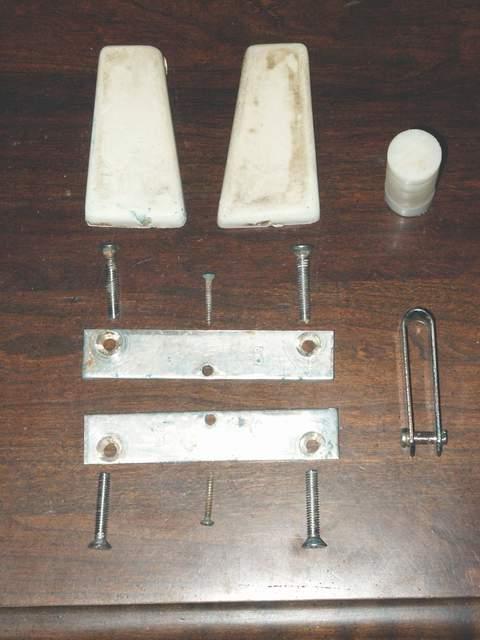

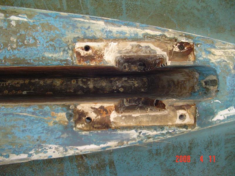

Have you looked at the bottom of the keel? I'm not sure if the later model O'Day 23s have the same set up as the O'Day 222, 192, 25, and 26. If it does, there should be two stainless steel plates under the forward part of the keel which are held in place with four 1/4" Phillips head bolts. There should also be two wood screws that hold the two fiberglass wedges behind these plates. The wedges fit in grooves on each side of the keel slot and they support the fiber pin in which the centerboard rotates on. Check this out and let me know what you find.

Check through the archives on this site on removing the centerboard. I remember walking someone through the process a few years ago on this site.
Probably the hardest task is going to be getting at the under side of the keel. Get your boat in a position where you can get at it and then get back to us for more info. The plates need to come out first. Try to do this without breaking the bolts.

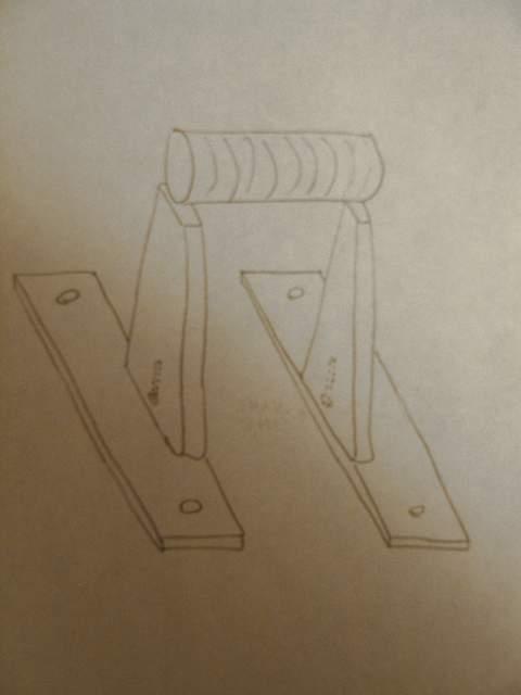

It was my pleasure. I only wish I could be of more assistance to you but I'm not all that familiar with a 1979 O'Day 23. The only bolts that I know of are the four bolts that secure the two plates to the bottom of the keel.
On my boat there is bronze plates embedded into the lead on both sides of the keel slot in which these bolt thread into. The rest of the keel is lead. Theres a pipe that enters the top of the keel slot from inside the cabin in which the pendant line runs through for the centerboard. My pipe is L shaped and the pendent line goes through the pipe via a thru-hull fitting on the cockpit step in front of the companionway. There are two short pieces of rubber hose on this metal pipe. Also, I have a U bolt with a single sheave connected to it located in a small pocket in the keel slot.
