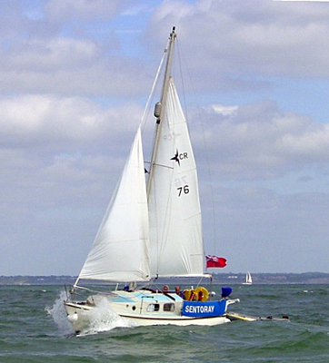

As you will know already Westerlys were built in Britain and there were very many of the Centaur.
There is a lively class association in existence and I feel sure they would be pleased to offer advice whether you are a member or not; but the subs are modest should you wish to join.
See http://www.westerly-owners.co.uk/ and Centaur the pic below.
You might wish to convert to slab reefing with the reefing lines lead aft and no need to remove sliders from mast or go to up on deck at all.
I owned the Pageant for 7 years and it is the little sister to the Centaur and it was my 'starter' cruiser also.
From my viewpoint both Westerlys are first class in robustness and handling.
