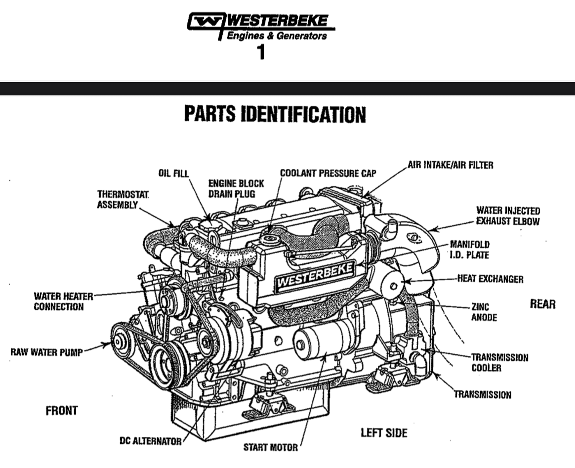

Here is the engine.

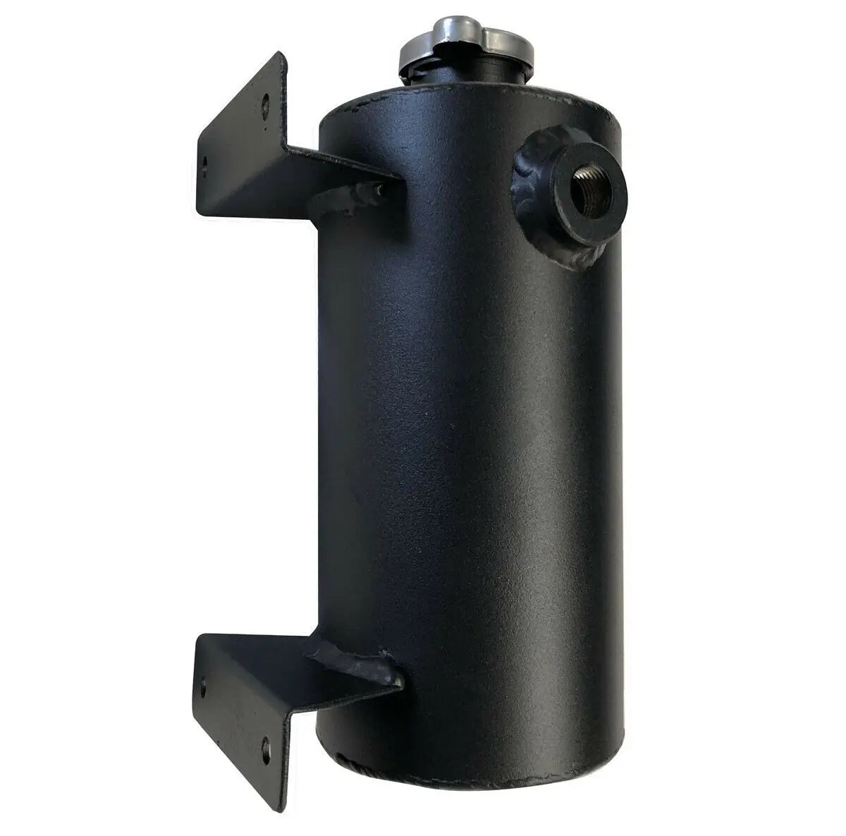

The tank under the coolant pressure cap provides a reservoir for the engine coolant. It is pumped through the engine by the “freshwater pump”.
You can add an expansion tank if you modify the coolant pressure cap.
Here is an example:
This on is made of aluminum. You fill it half full. Connect a hose from this tank to a fitting at the pressure cap. When there is a loss of fluid in the coolant reservoir it draws coolant from the expansion tank. If pressure builds in the reservoir some coolant can be sent to the expansion tank.
I have only seen then as an after market item on diesels or as now a normal part of automobile engines.
