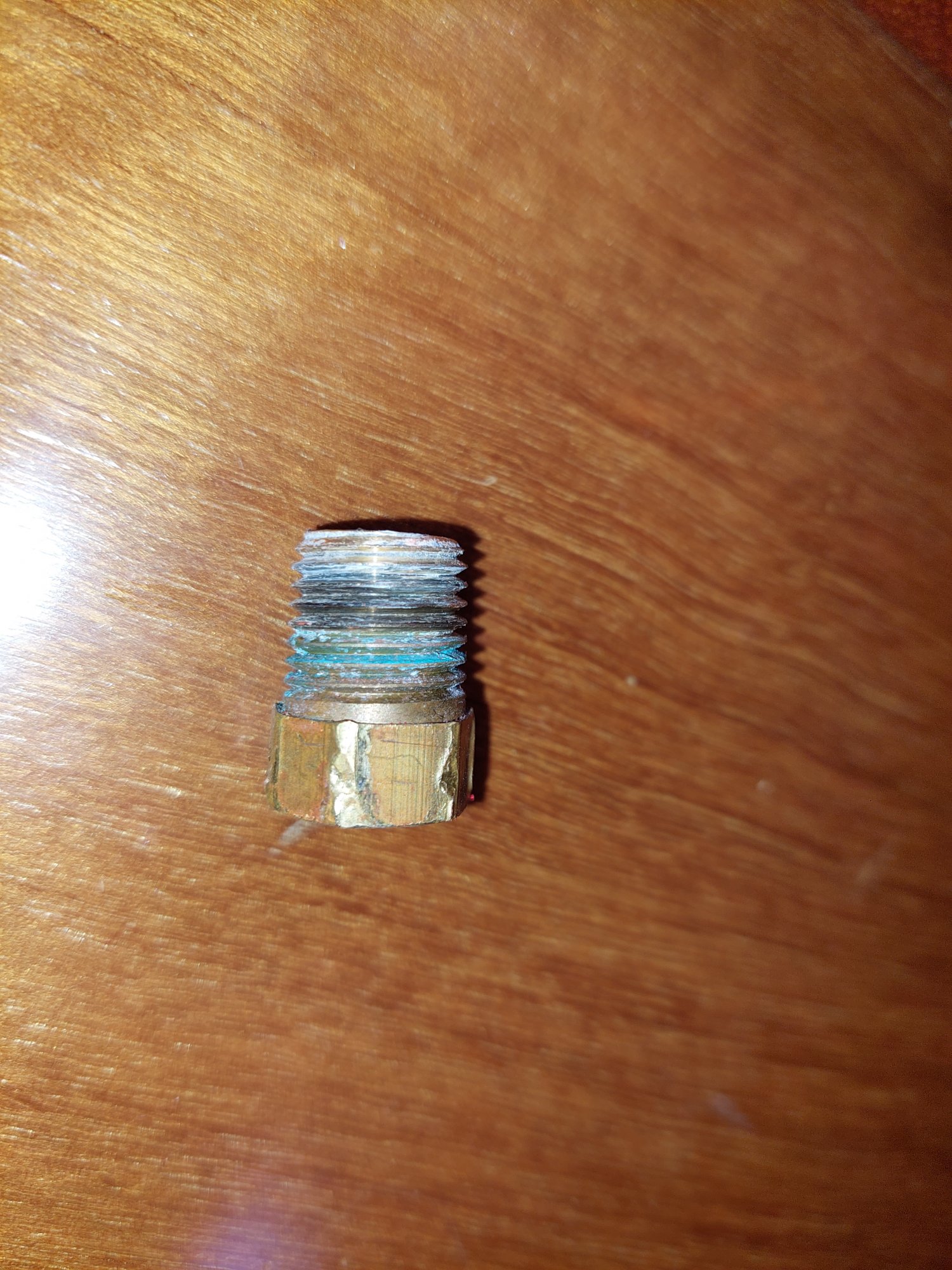

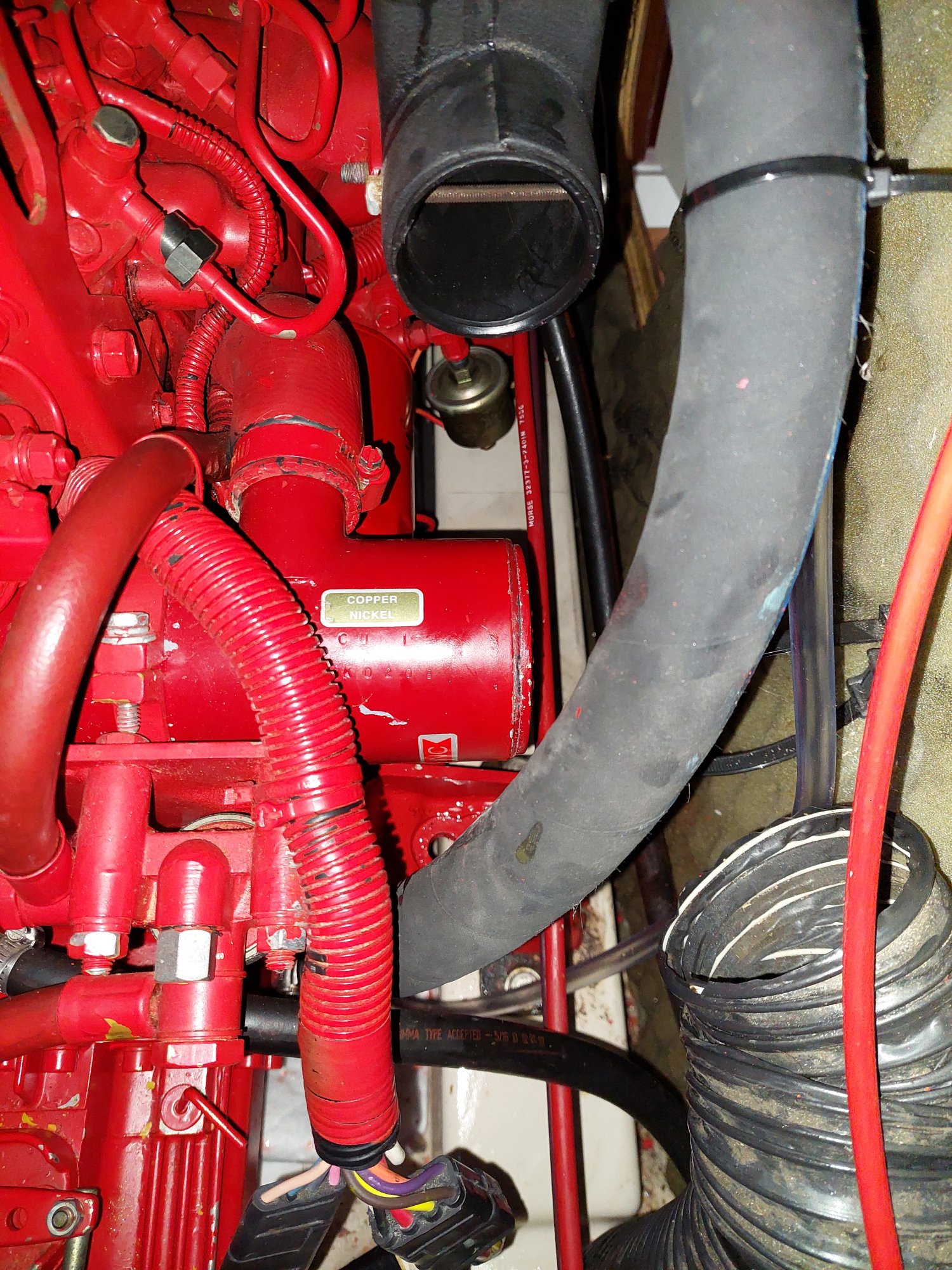

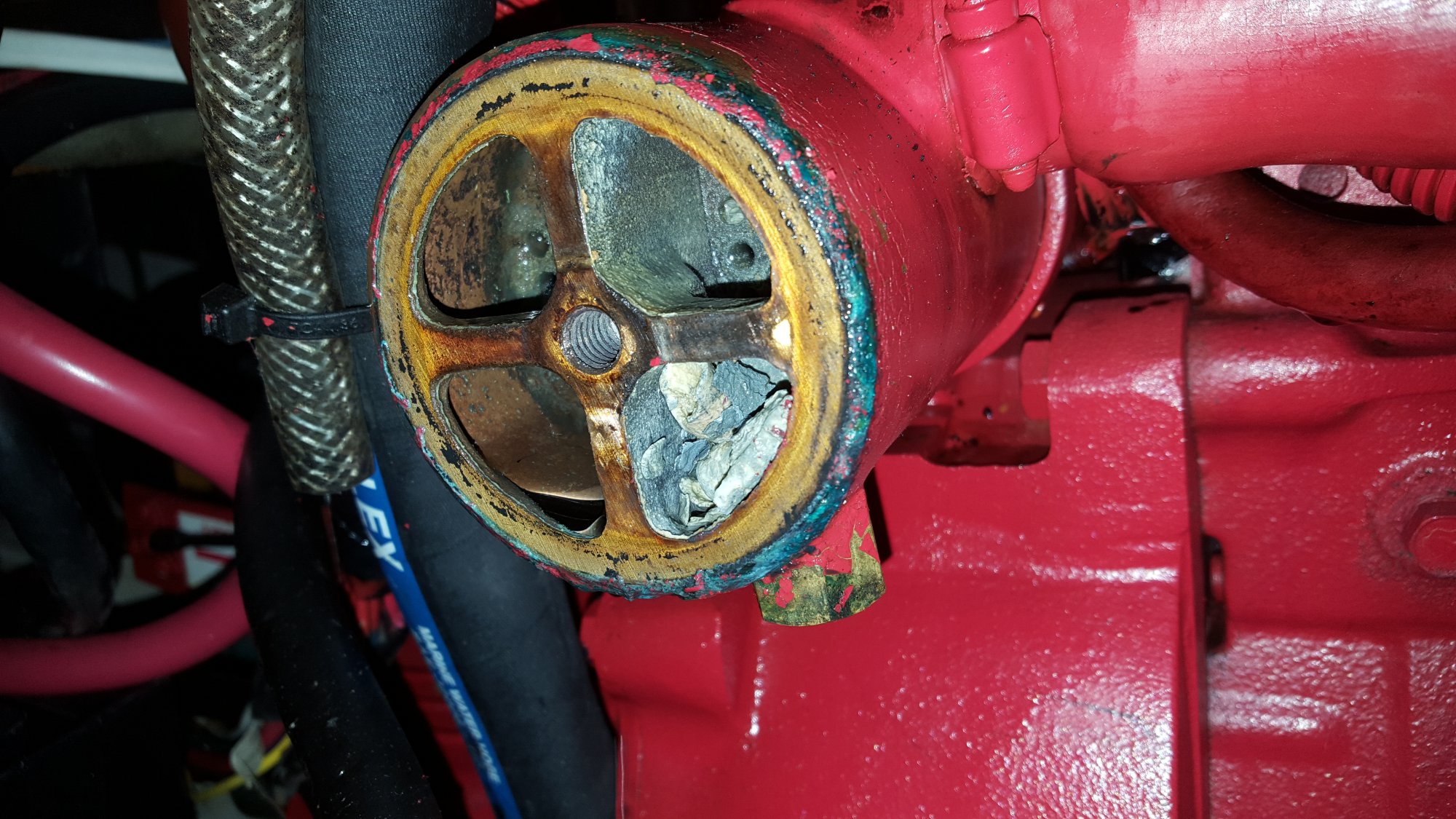

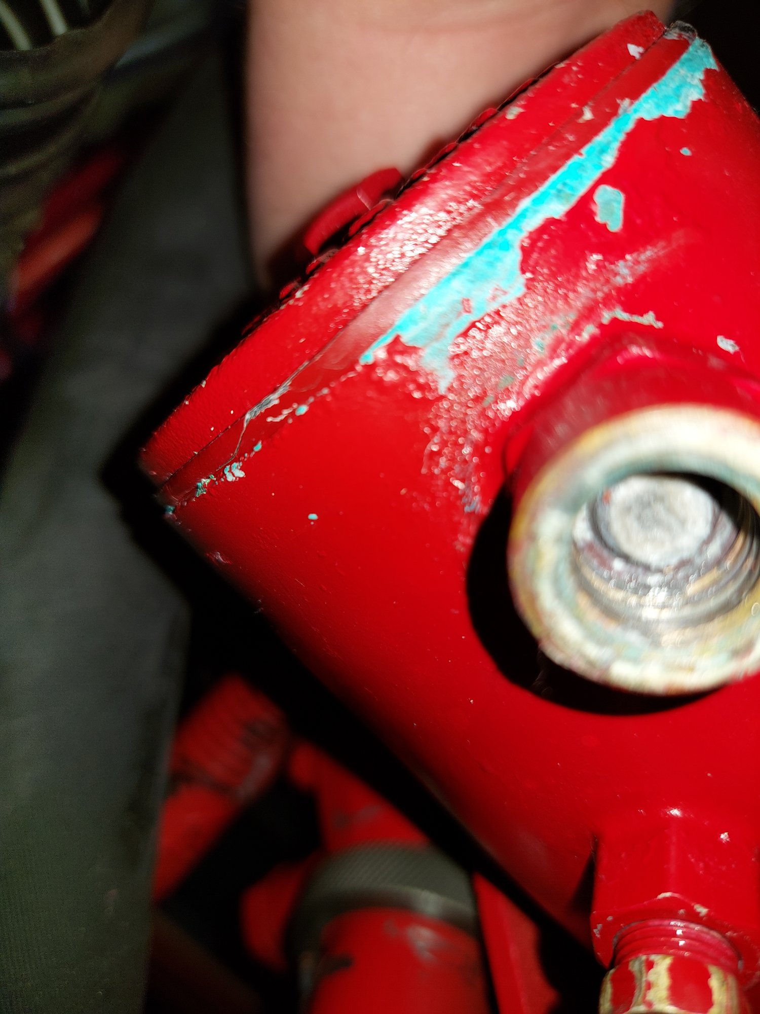

So this saga continues, today i tried to replace the zinc and got the old out. Looks like zinc was snapped off... I then thought I'd remove the plate at the end of the heat exchange but couldn't get the cap off and didn't want to ruin the seal or pry too much.
So... Anyone have a tip on removing a heat exchanger end plate with gasket that's painted red and hard to get to? I want to get one of my pry tool from home but figured I'd ask before hitting it too hard.
Pictures attached, first old snapped zinc, second exchange cooler end cap, third zink inside heat exchange, last a shot from above for reference.

You are going to want to get to the inside of the heat exchanger (HE). Does not look like you have much room or access to the side of the HE. So you will want to remove the hoses and then lift the HE out of it's nesting space on the engine. Once free you can try a strap wrench on end of the HE. It would be my guess that there is a bit of paint holding the end on the body. She you soften it up with a little paint thinner. Then it should release. You are going to want to clean the tubes that run the length of the HE. Most use a small rod to clean the tubes. I believe a 22 cal rifle cleaning rod works in the tubes. I think some mechanics have access to welding rod of the right diameter.
I found the easiest to do is to take the unit to a radiator shop hand have them boil out the HE, then close it up and pressure test the unit. When finished it can be painted pretty red. The cost was $65 to clean my HE.

I am not clear as to why you are trying to remove the end plate. If you are trying to remove the broken zinc, I would leave it inside. Even if you remove the end plate you will not be able to remove the broken zincs. Take a 1/4" drill bit and rim out the broken zinc in HE. It is actually 3/8" in diameter and you can use a 3/8" drill bit to completely clean the opening. Then the zinc in the bolt you can dig out by using drill bits.
Then replace the zinc, whipe the threads with pipe thread paste then screw in. This will make it easier to remove next time.

Not sure about your HE zinc, but mine is visible in the space between the cover plate and the ends of the raw water tubes. Taking the cover off gives you access to the tubes and space the zinc occupies. It can be remove with a pair of needle nose pliers.
No drills were needed.

My zinc broke off this year. I removed the center bolt as you did and the cover should be free. Paint probably holding it. You can see the rubber gasket in your third pic. Yes, you can remove the broken zinc from the end. The drill will be needed to get the threaded stub out of the plug (your pic #1) or just buy a new plug with the zinc. I use Boatzincs.com and buy 3-4 years supply at one order- saves on shipping.

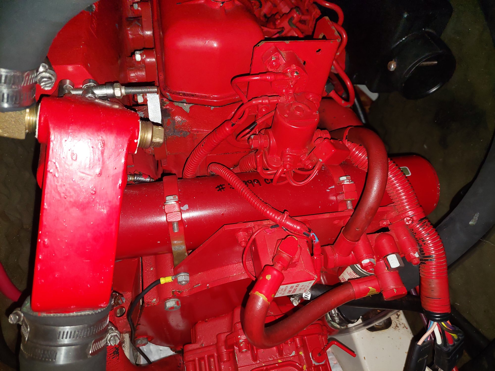

Trying not to overthink this but surprised how bad the manuals are. I had a look at the HE again and tried to come up with plan for removal but the dang thing is strapped in with straps that disappear and tucked in behind a fuel pump and below some relay and reset fuse. From the look of it either of those has to be removed, with no clear instructions.... One online source said removing HE from 42 was easy but that's it.
Anyone have a tip on how to unbury the thing from it's tucked in position? I'm not a total mechanic novice but with no instructions I'd like to have some idea before I start removing stuff.
23,262
Each engine can be a little different on boats,
Take some pictures from different angles. My HE was attached with straps.
I first disconnected the hoses. The coolant and raw water dripped a bit. Prepare ahead and capture what you can. Like suggested this is a great time to plan on changing the coolant for the coming year.
Once free from the hoses you may get a clearer look at the HE. I had straps. They had screws to turn like hose clamps. I used a small socket with an extension to loosen the straps. Then I was able to slip the HE out of the straps.

Took some pictures and had a look at the bracket on top and bottom. To me the bottom looks easiest so might give that a go. Only issue i can see is the bolt on right where they conveniently placed behind the fuel filter... Thoughts?
