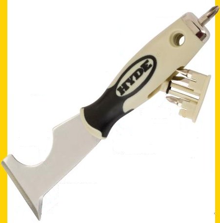

Getting the old stuff out isn't even half the battle. Cleaning the surface so the new stuff sticks is what is time consuming. The Multimate tool didn't help on the silicone it just jiggles it back and forth. It does work on sanding out the contaminated surface. The tool that worked the best was a good old fashion scraper.
