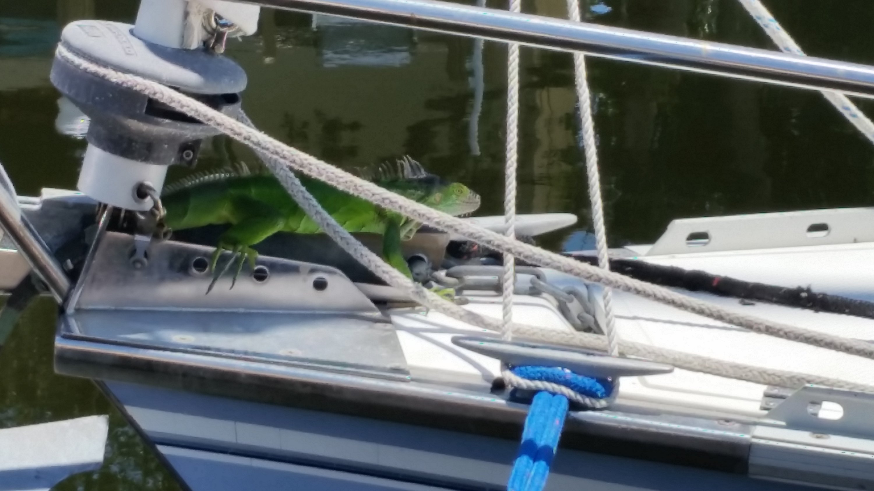

What size line does your furler take? My line is so old, it is difficult to tell.
Looks like the PO used StaysetX for this line. Would regular Stayset be OK?
Picture of my furler. The green rat is just a bonus.
Mine is 7/16". I don't see why StaSetX wouldn't work. I am no expert. Their chart might help
