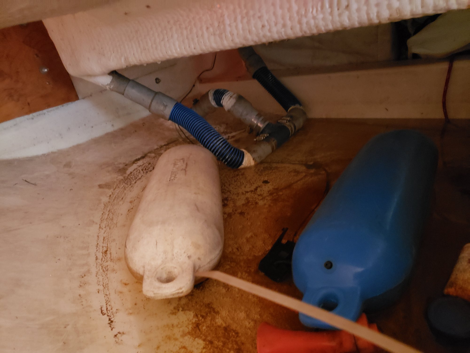

I went back to look at a hunter 22 today close to me.
Few observations I would like to know if I should be concerned.

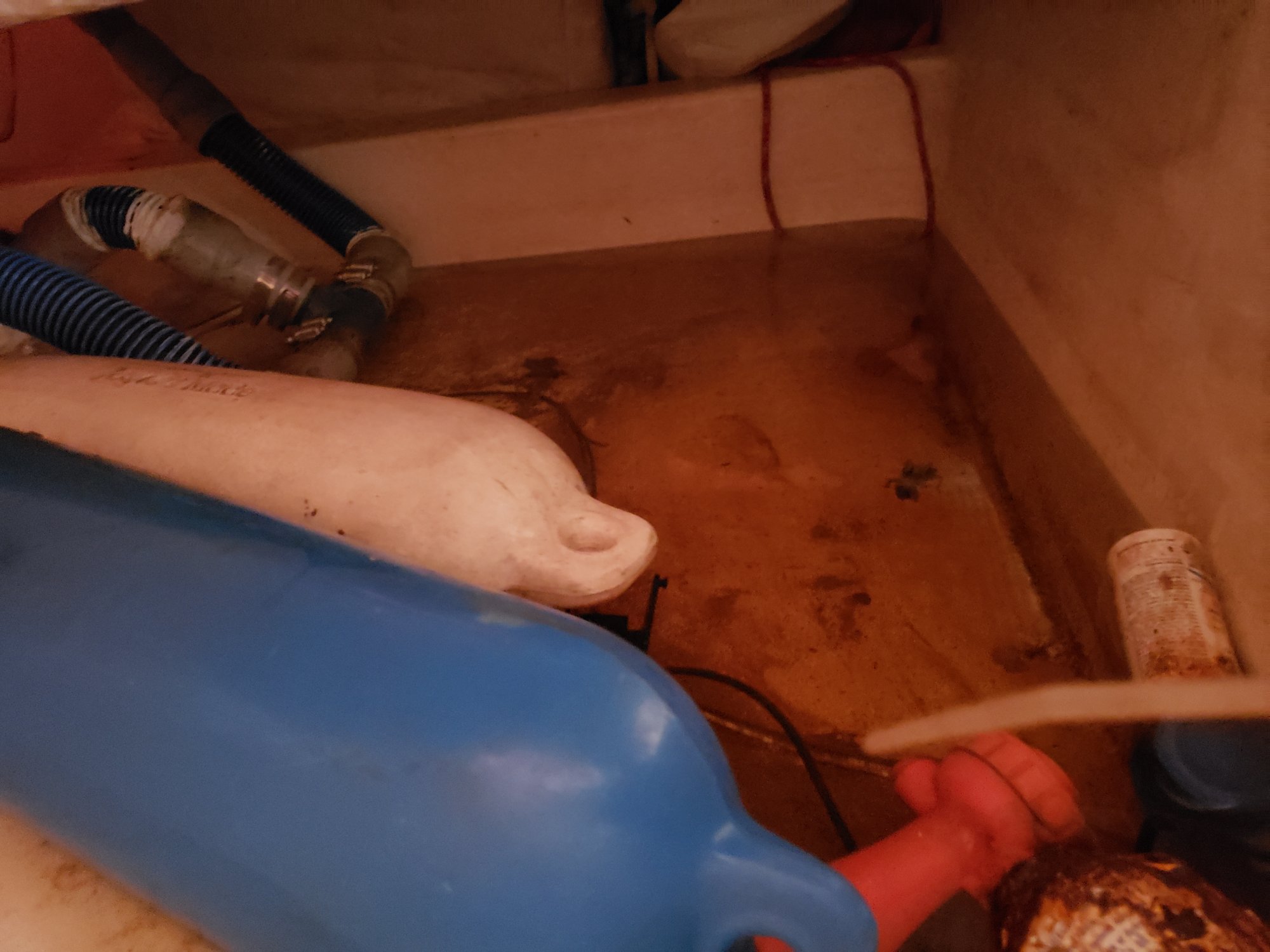

I noticed a bunch of water inside.

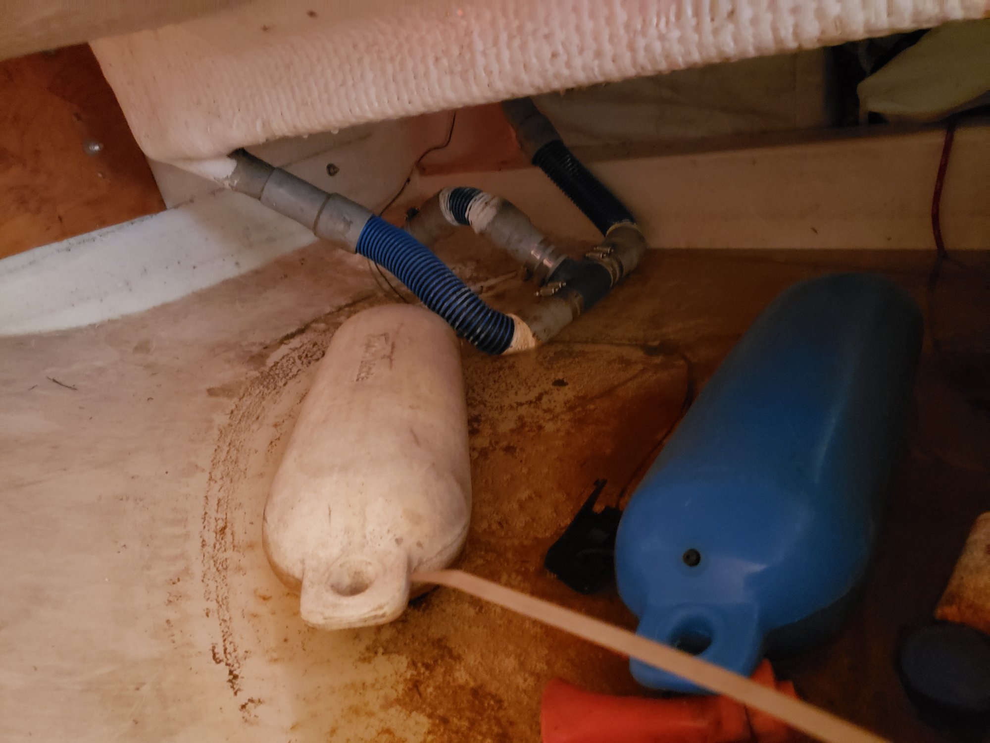

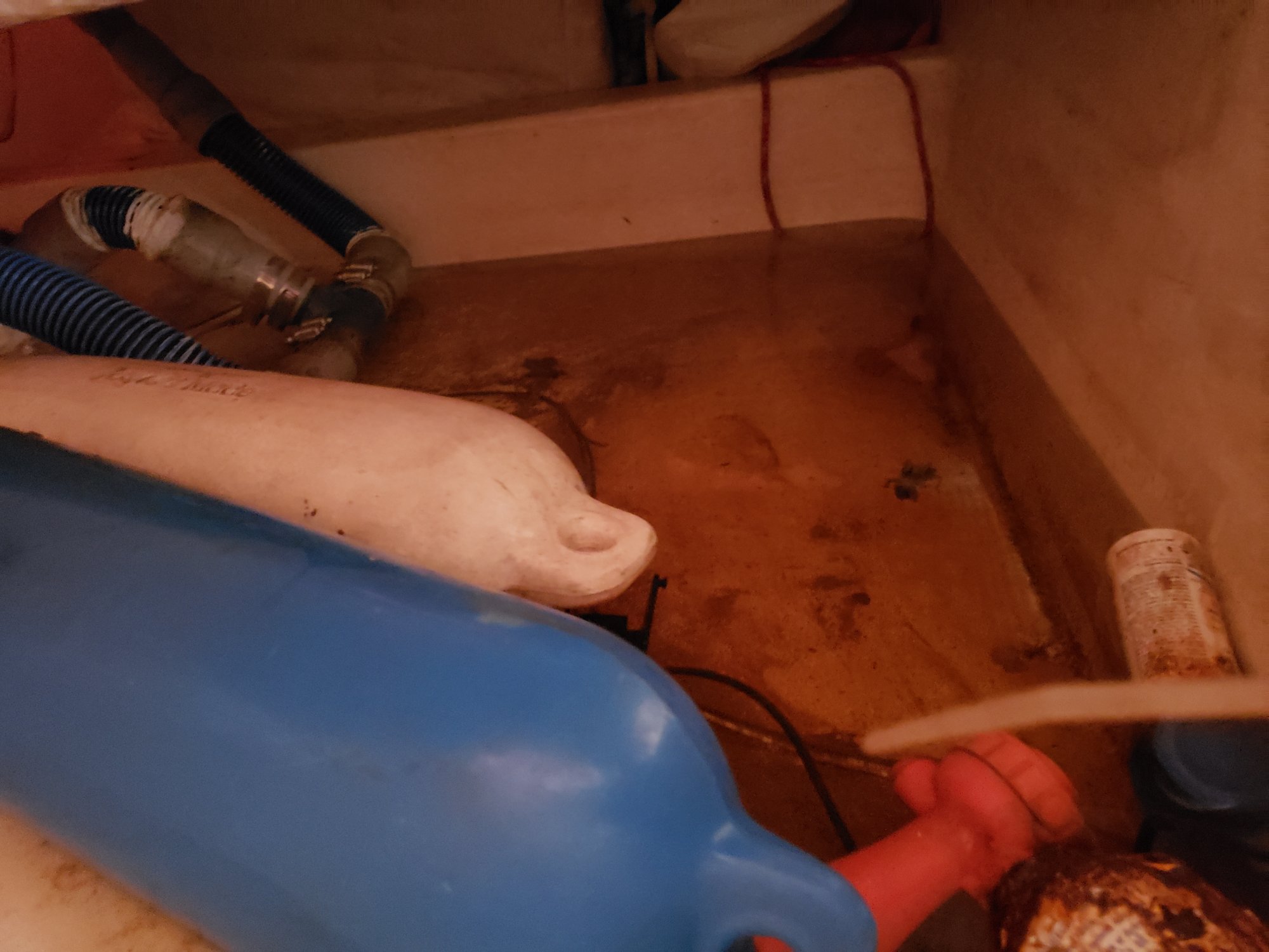

Namely in the bilge, around the swing keel bolts and in the space under the cockpit, behind the stairs and sink,, where the cockpit drain lines run...
Now, its been sat in a driveway for 5 months so its not taking on water floating at a slip clearly.....
The companion way isn't secure as I guess most boats aren't and we have had some heavy heavy rains in the last two weeks. So it clearly has to be rainwater...

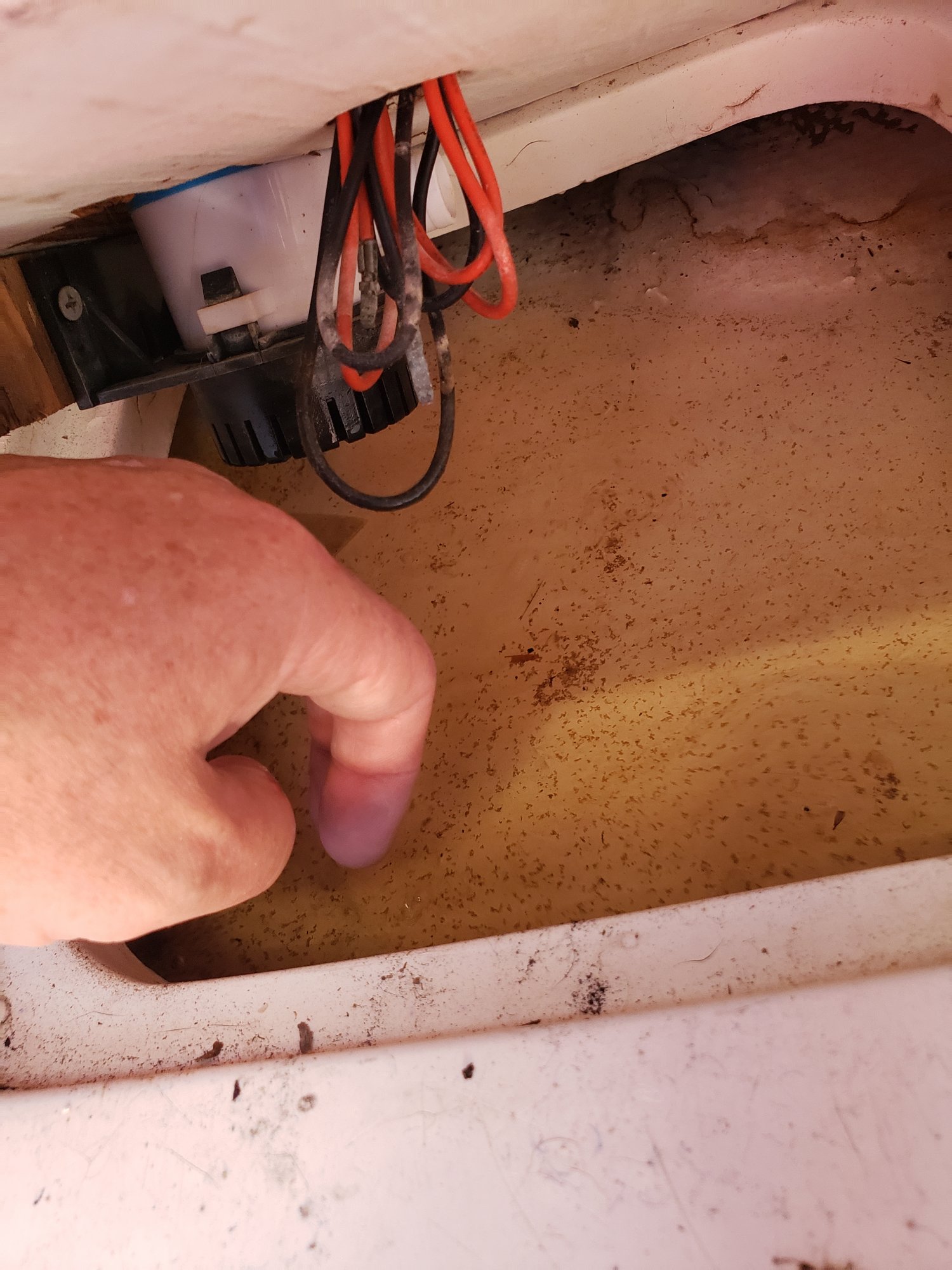

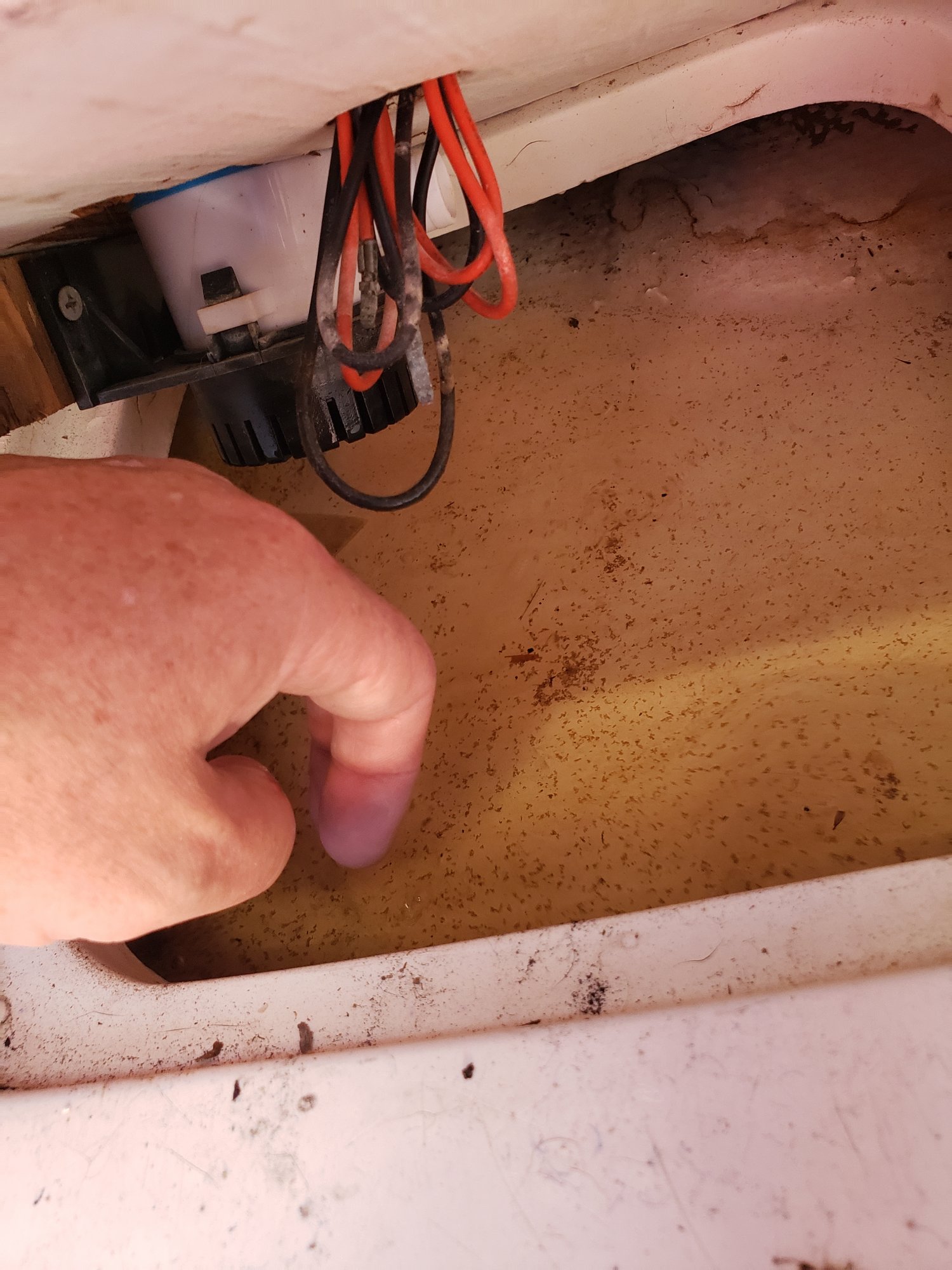

The bilge pump is located under the sink and what I think is an icebox....which is also full of water.
As I crawled around it looks like the area the bilge pump is located is higher than both the inspection area where the swing keel bolts are and also the area behind, directly under the cockpit, where the cockpit drain lines come down and run out.
FYI, there is a bilge pump but it isn't connected, so am aware its not working...
So my question is....
1. Is the bilge pump in the correct place to catch the lowest lying water. And would rain water, with a non connected bilge pump overflow into those other areas ?
2. Is it possible the cockpit drain lines are leaking and are able to make their way from those lines into the bilge pump cavity and the swing keel attachment cavity ?
3. Most importantly, how important and easy it is to determine if this should not be happening, or is simply an insecure companionable, or drain lines ?
If the boat was floating at a dock, I may be more concerned.
My 13 year old said, its a good thing that no water is leaking out, so none should leak 'in lol.

As im sure everyone feels the same about, getting a boat thats had the major areas of concern addressed, ie swing keel etc, a good motor, a good set of sails and a good trailer is hard..

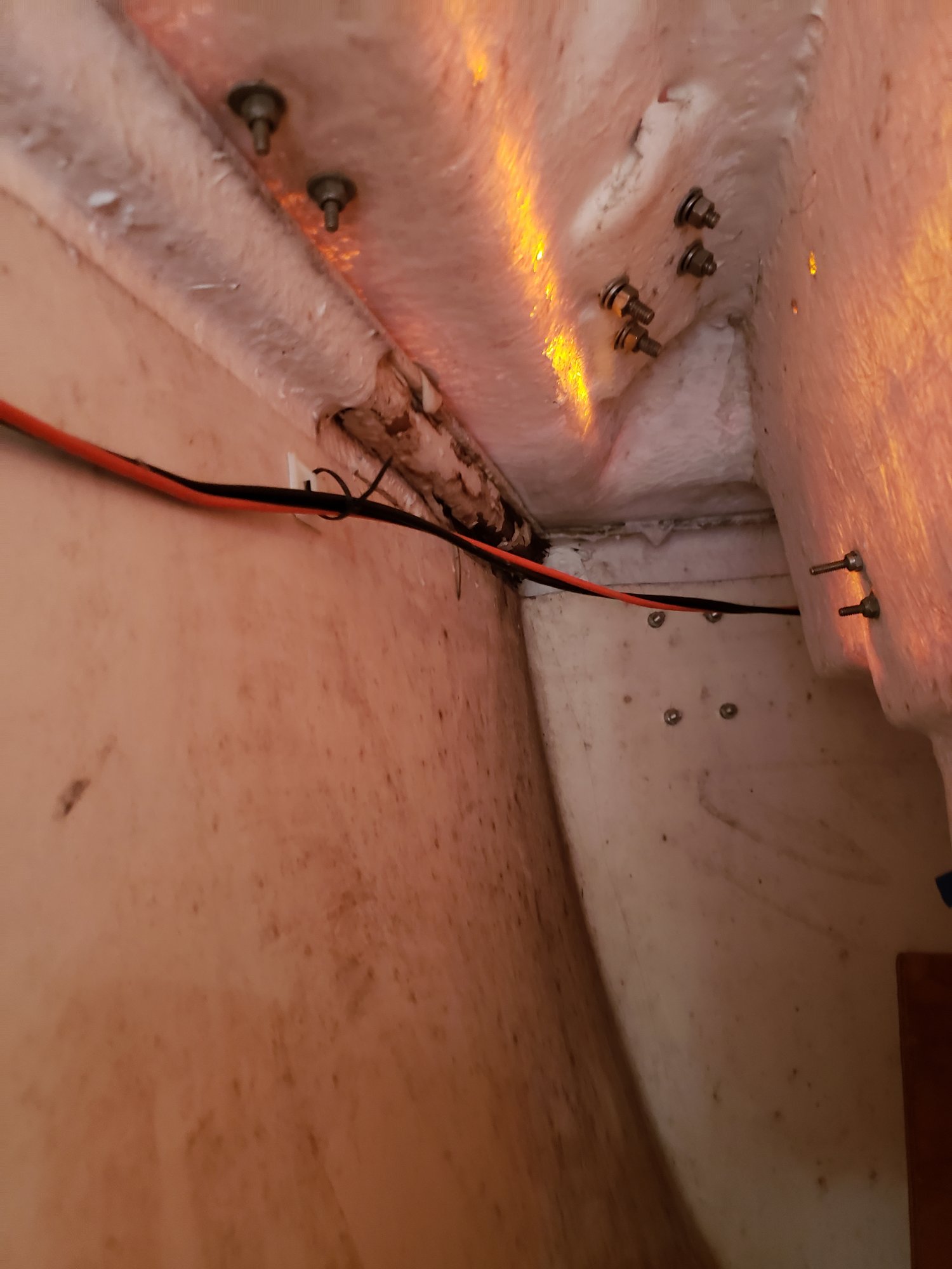

I see an area at the rear up against the transom thats been wet. How is that wood that runs along the joint between the hull and the deck attached. Could I cut out and repair it and what's its purpose ?

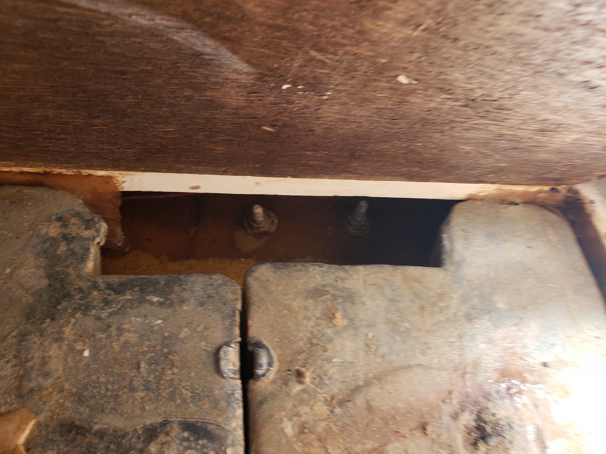

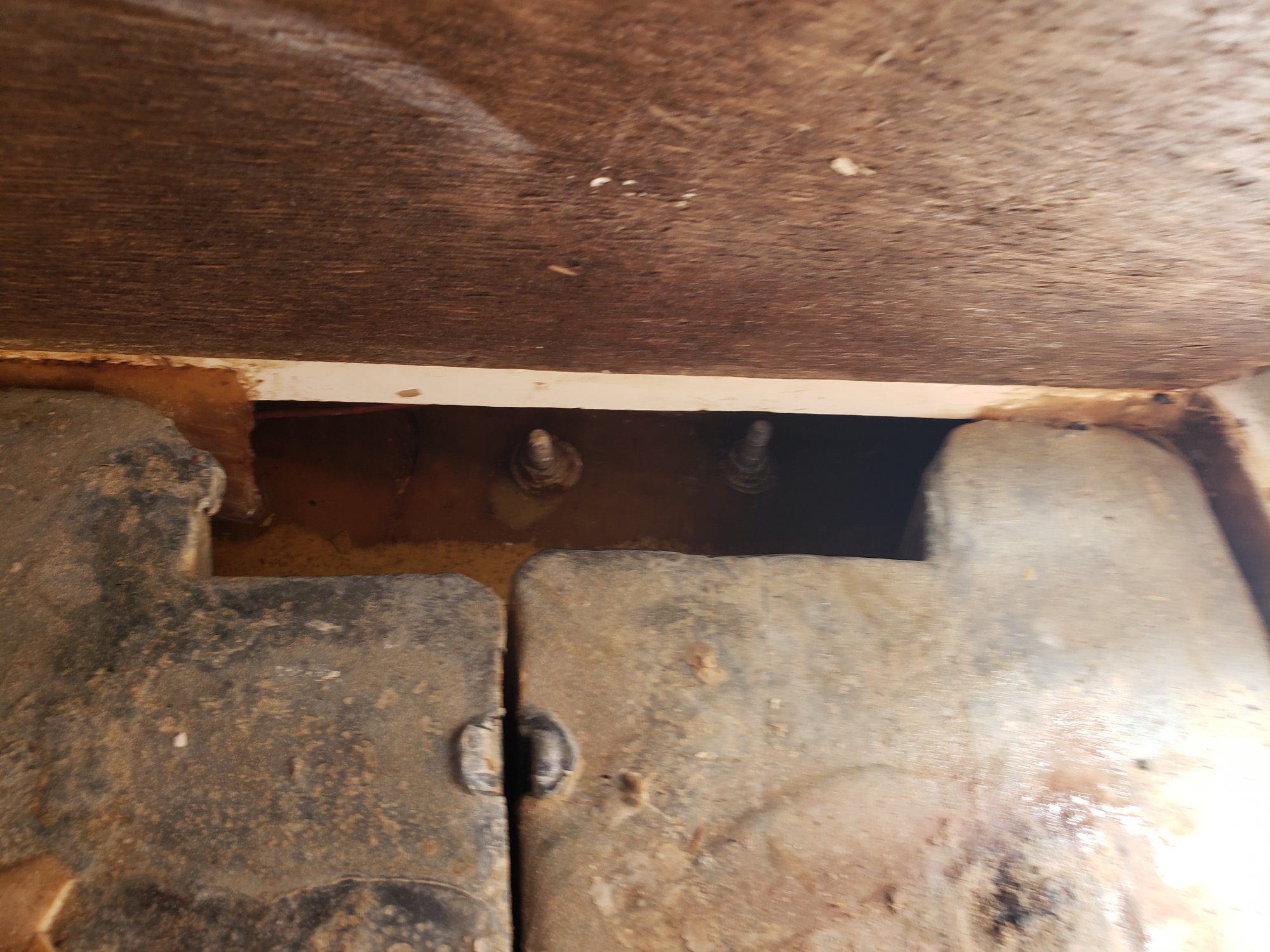

Could water sitting around the keel bolts cause a problem with any wood down there ?
Obviously it shouldn't be there long term. But the bolts look clean as they were replaced last year and not corroded. Clearly it should be removed as soon as possible.
I'd hate to pass up an otherwise decent package for a leaky companion way that I feel is in my ability to repair, if that's the cause.
I dont know if anyone inc the seller, is qualified to answer how that water is getting in, without sitting in it and waiting for it to rain..
My questions are twofold...
Can I make it watertight and has it potentially caused any other bigger issues.

That pump will leave .5-1" of water in the bilge. You'd need a dry bilge system to get it all out.
Where would that go, in the same place or the lowest point on the inside ? Where would the lowest point be ?
