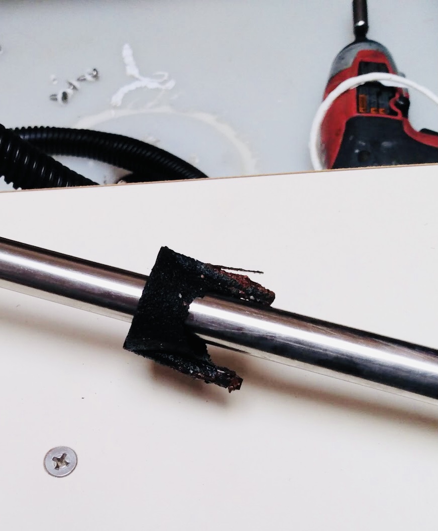

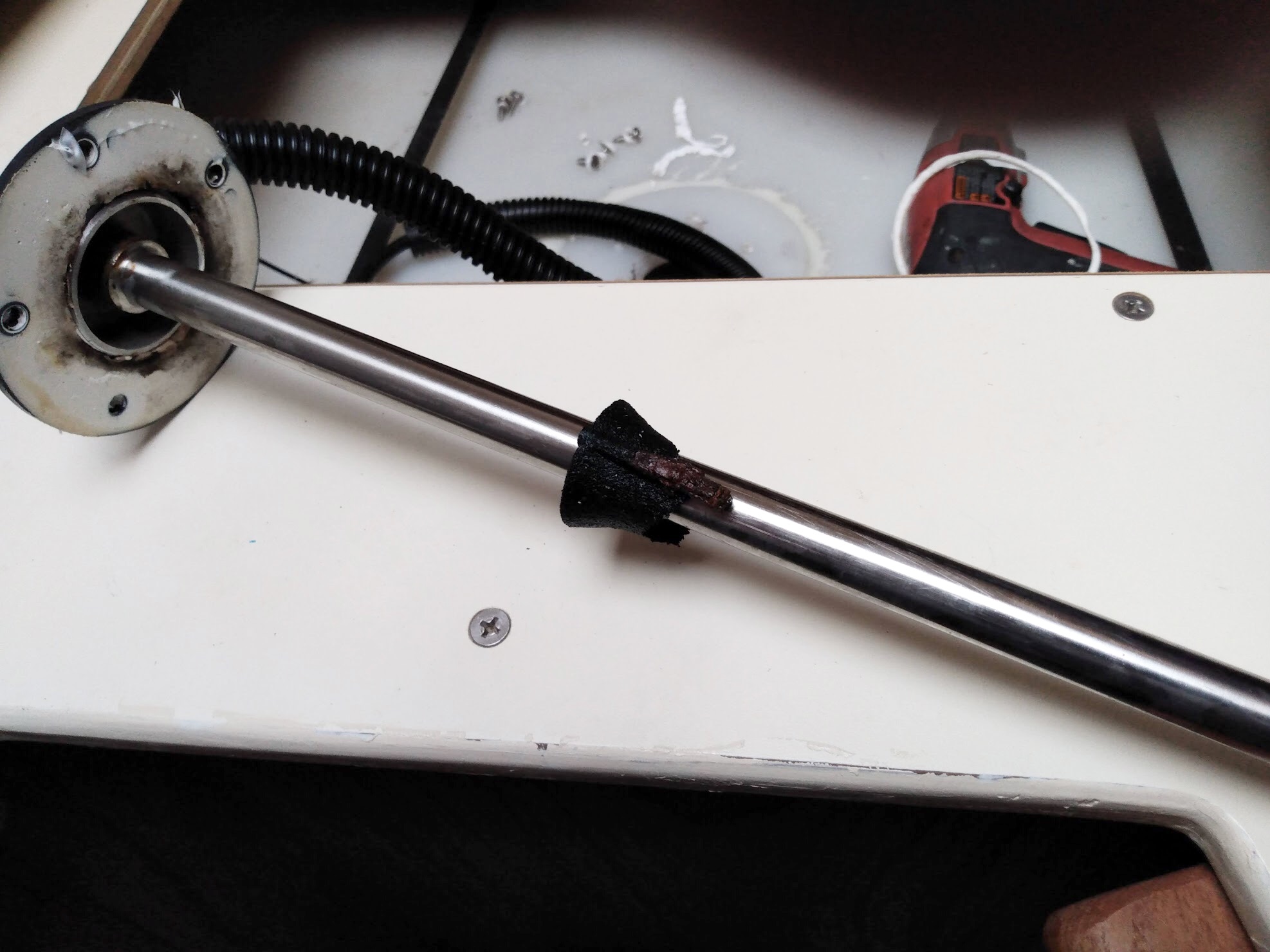

I have to replace my WEMA Fresh Water sending unit. (2000 Hunter 340)
I have the SSS/SSL Model Sender. The float has rusted and was stuck at the bottom of the sending rod. (Not now, I took it out and freed it
Why it was made with a metal housing around the float is beyond me. Seems it should be the other way around. I replaced this once before in 2012 and spoke and dealt with WEMA directly. They custom made the rod to your measurements back then. Either I’m missing something online but I can’t seem to find that WEMA site.

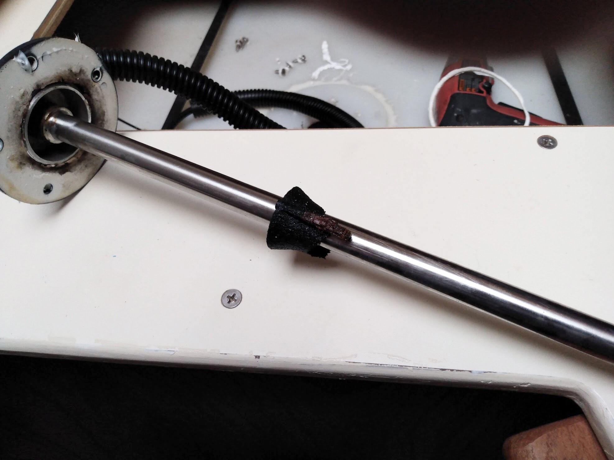

An update for others with replacement WEMA Senders on their boats, dating back about 5 years or so. I heard back from WEMA (KUS). I removed the unit from the boat, took clearer photos so they could see in better detail.
They said….”Firstly, you have the S3 sender. The black flange should have stayed bolted to the tank and the sender just unscrews anticlockwise from the flange so you don't have to remove any bolts.
I can tell that this was made by the former company that used to be called Wema USA. They had different ownership and for certain products they went their own way and we did not have visibility or control over what they were selling. They no longer exist so I think the only thing I can do is to sell you a replacement part and hope that you notice a difference in terms of output resolution (about 2 x more accurate that your current sender). This should not happen to one of our floats but on a serious note maybe it's worth checking the drinking water is not contaminated?”
I removed the flange to see if the caulking had deteriorated and caused contamination into the tank. But it was solid to the tank and now has to be re-bed. Easy enough.

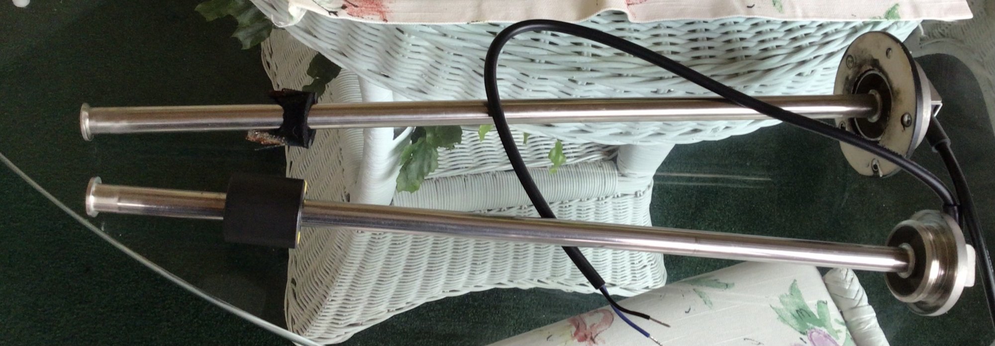

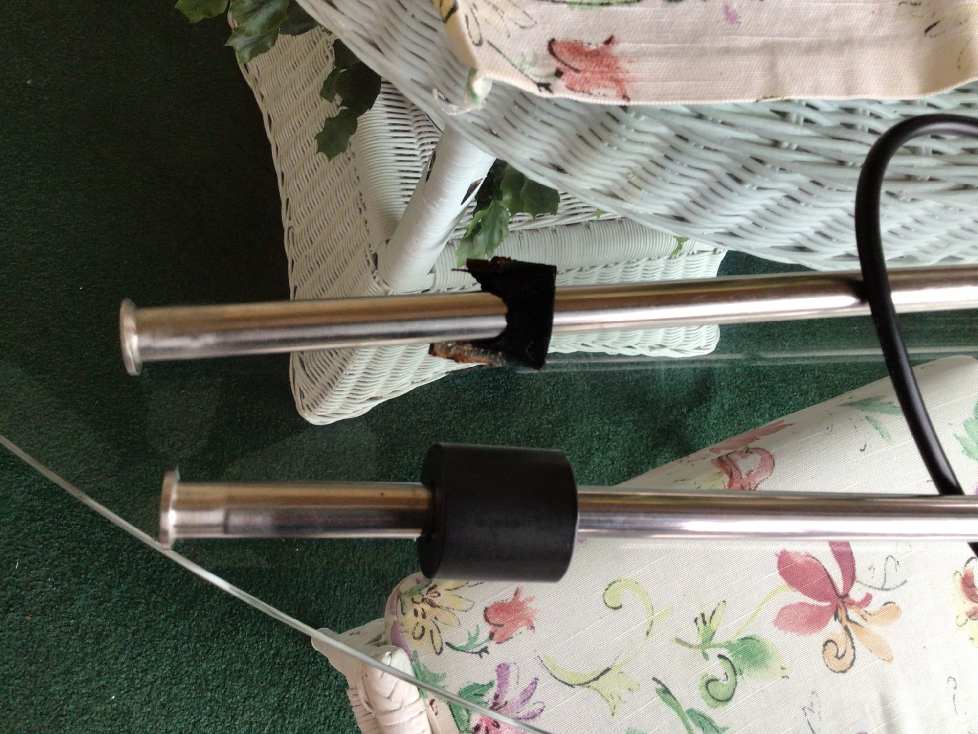

My new WEMA sensor arrived today. 3 days earlier than promised. Here is a couple of comparison photos to see the difference. Talk about catastrophic failure. What ate this away? When I first removed this to see, I had it in my mind that I would find mold or a film on the sending rod, simply clean it and be on my way, not what I saw.

We were just siting at lunch with some friends at the marina and it's mine and everyone's opinion that chlorine is the problem. That being said, my adding about 10-12 ounces of chlorine to the tank (75 gallons) when I commission the tank in the spring is not to aggressive. Especially since it's followed by 3 minimum tank rinses before launch.
The water itself does not smell or taste of chlorine on a daily basis, when drawn from a tap, not on the boat. But it can't be anything else or just a faulty float from the beginning. And it absorbed some chlorine at some time and started the downhill process.
I'm at a loss as to how, so I'll replace it now, and watch it as time goes on.
