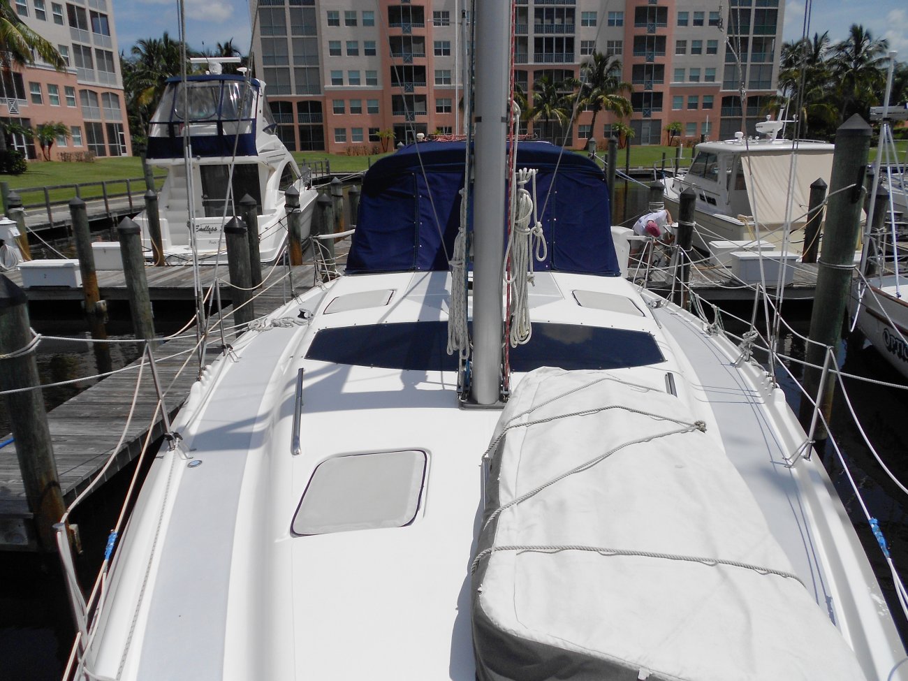

Pumpkinpie, I’ll be on the boat Sunday. I’ll shoot a picture for you. I just got a 6hp Yamaha. Have not even been able to put it on the dinghy yet. Working on a place to store the outboard on the stern pulpit, and a way to lift the motor (65 lbs) out of the water and not drop it. Lifting the dingy by the spinnaker halyard has worked so far.

We would have loved to have been able to go with a steering column and seating setup but it's not going to go with the 38. I'll remove the steering wheel setup go with just the dinghy and a 25 hp. 9-10ft should been perfect. @jssailem - chance you have a pic of your dinghy setup or anyone for that matter?
