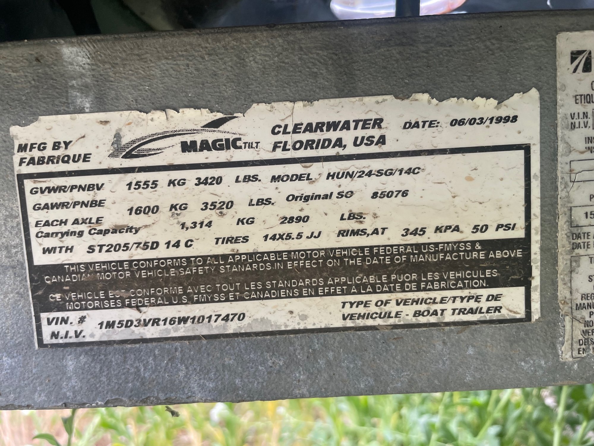

Single axle trailer, mast and boom were on board. No sails, no battery, anchor was in the locker, no supplies. We went out to float it, motored around. Our goal was to weigh it on the way out and then weigh it when we came back in (they matched) Our trailer is made by Magic. I will go down and see if I can find some info on it.

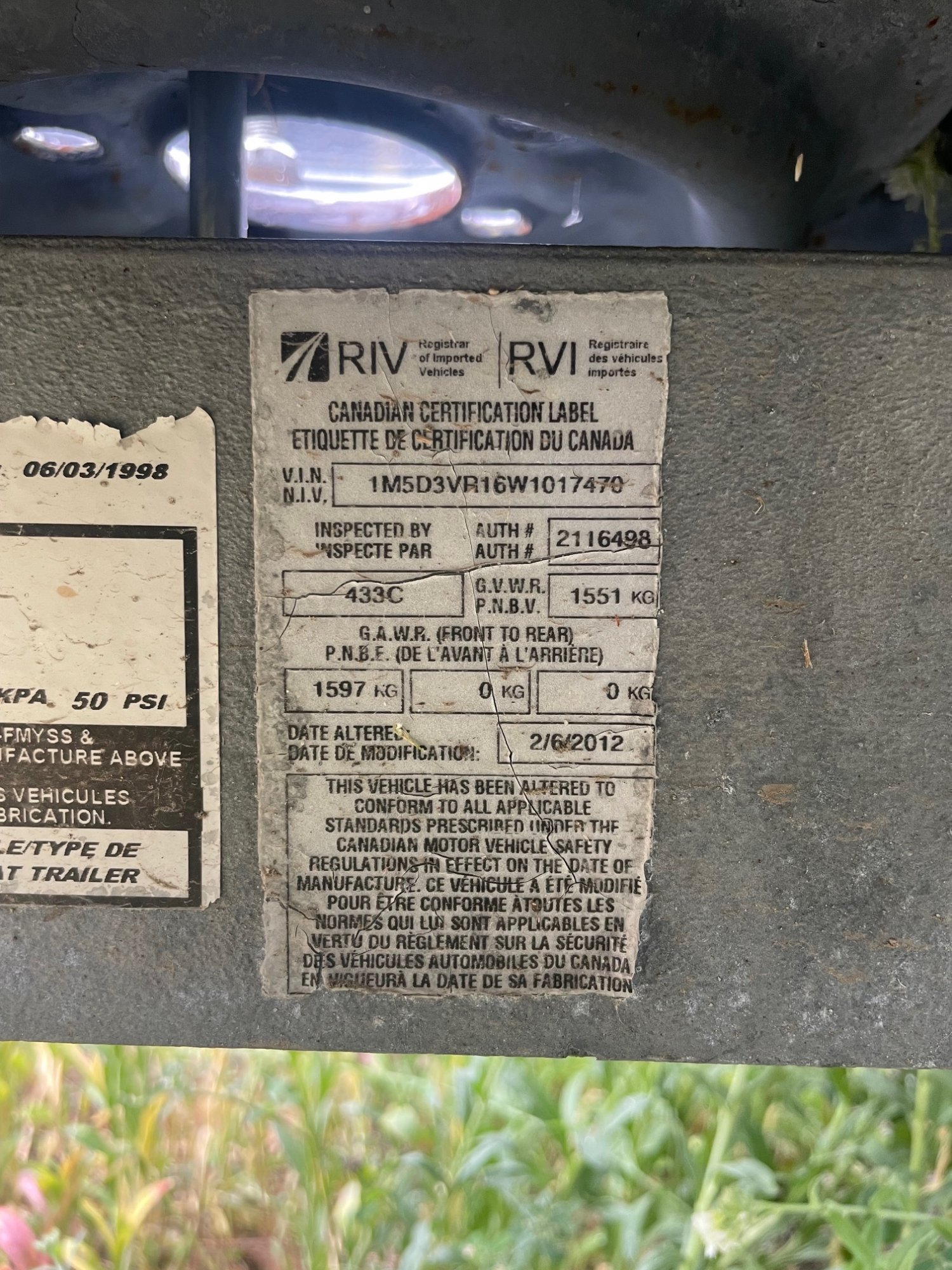

Great info. Thanks for your time. Based on Gvwr minus carrying capacity your trailer weight works out to 530lbs. Mine is likely very similar. An estimate of 2840 lbs towing weight is probably pretty close allowing for some extra "stuff" in the boat.

I'll check out my trailer nameplate when I'm up at our cottage.
Thanks for your posts.

Please post a picture of the plate. Never saw one on my trailer if it ever had one. I'd have to look but I think the 980# figure in my head came from my vehicle registration which would be a good place for folks to check. The answer to the trailer weight may be right there.
