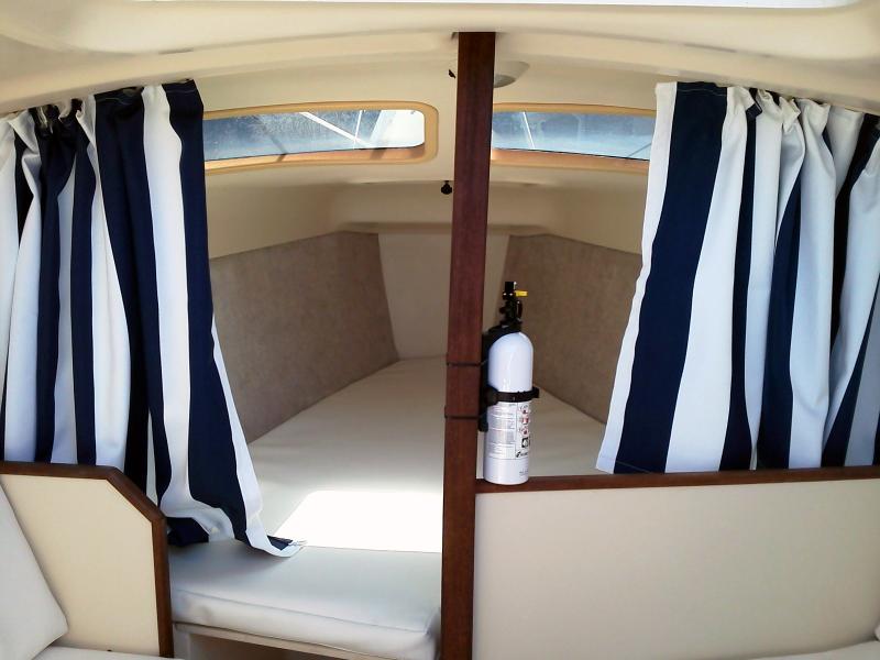

2. Over the winter I had new cabin cushions made in white. The old blue cushions were in bad shape, and many (including both berths) were missing. A guy around here who does upholstery for Monterey Boats made them out of white marine vinyl to give it an updated look. New foam for both berths. Very reasonable price and good workmanship - blue Sunbrella pillows next.
3. My wife made new curtains to replace the missing ones. $15.00 for the fabric (a 3 yard remnant of outdoor UV resistant fabric), plus thread, needles, and curtain holder tape from Sailrite, making the whole cost less than $50.00.

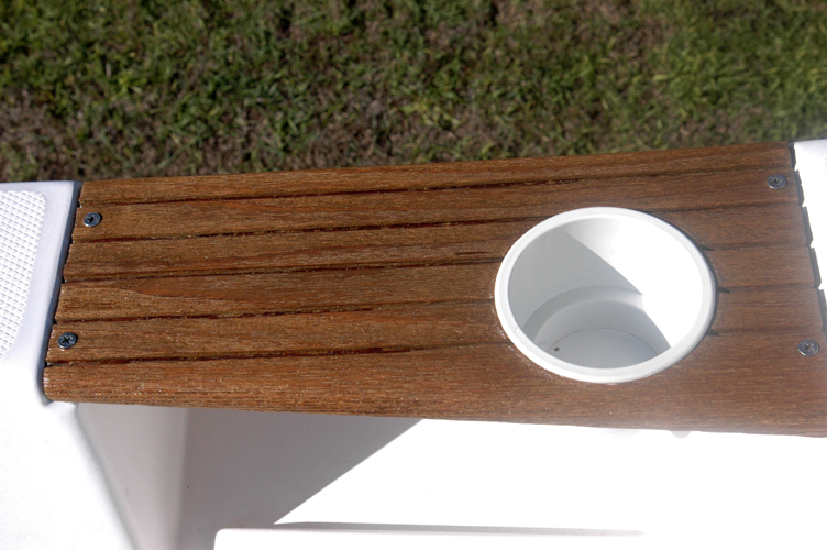

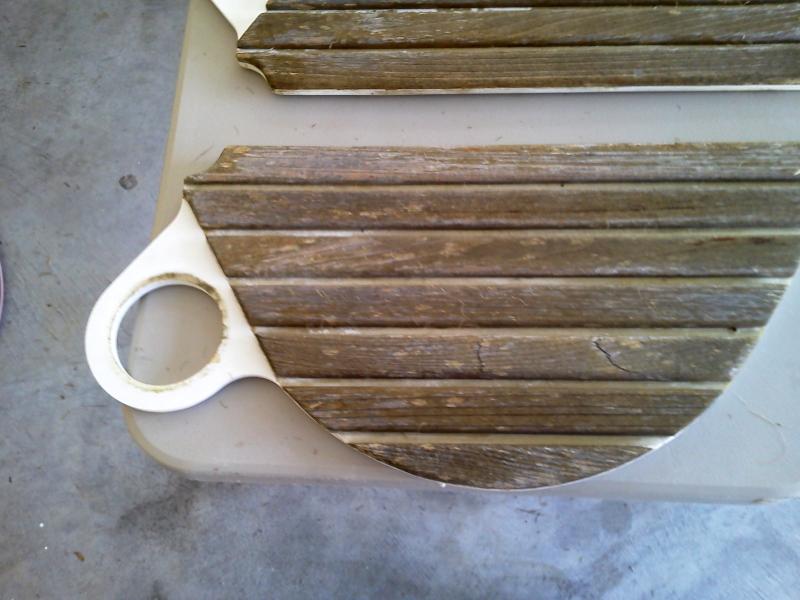

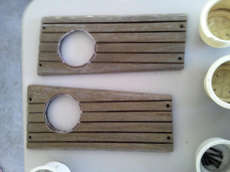

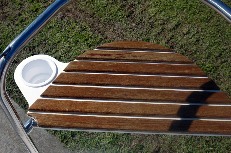

6. Refinished all exterior teak with 6 coats of Teakguard. The teak was in horrible shape, as shown by the pics. Also replaced the cup holders with new ones from this site. I like the Teakguard, let's see how it holds up.
