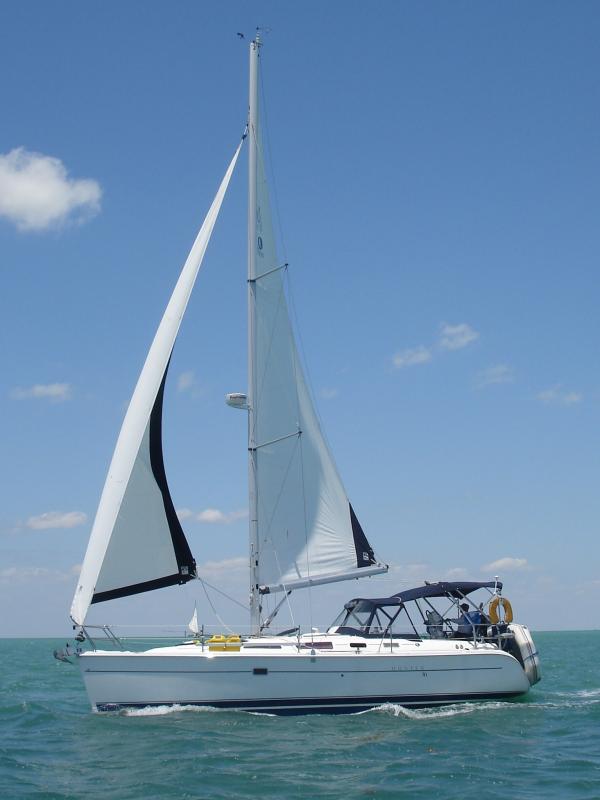

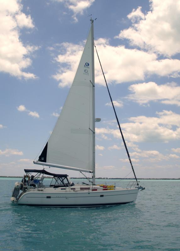

I have 07 H-36 and the 2 photo's are kind of far but I will look for more and also have snap davits for sale,I now have Ocean Davits. I used a 10' dinghy what size dinghy do you have. Nick

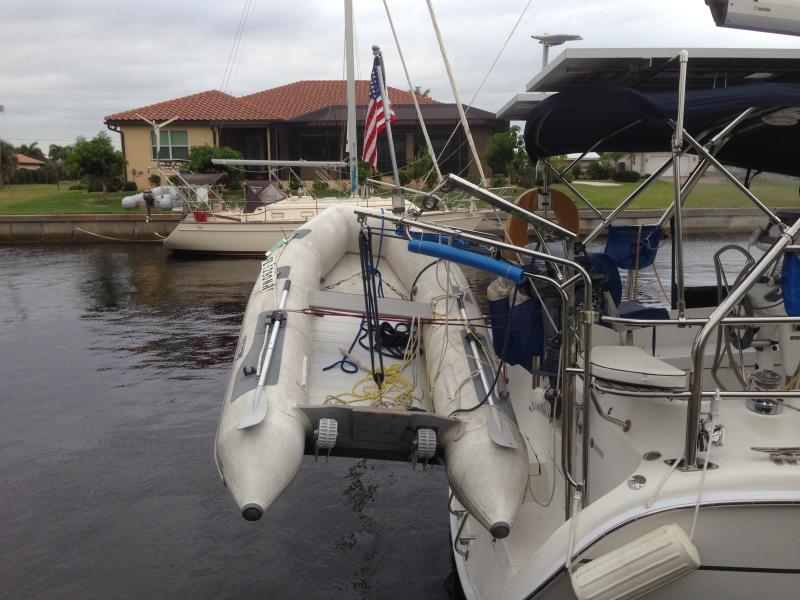

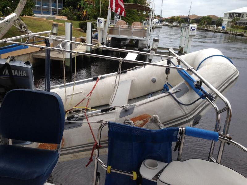

10'
My dink in photo is 10' and I got the $50 glue from defender
and did not have problem with pads coming off and my dink was hapolin
sanded the dink and pads before gluing.

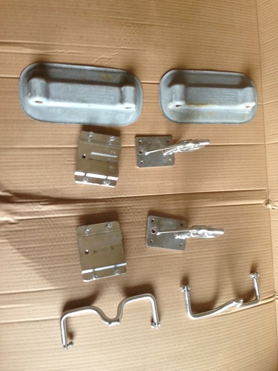

I picked up a set of the Weaver hard dingy davits at the Pompano Beach Marine Flea market last weekend for $10.
They came with these mounts
instead of the transom mounts like these:
I want to put the dinghy below on the back of my hunter 31, Do you think it will work with the mounts I got? Or will I need to buy the Transom mounts?
