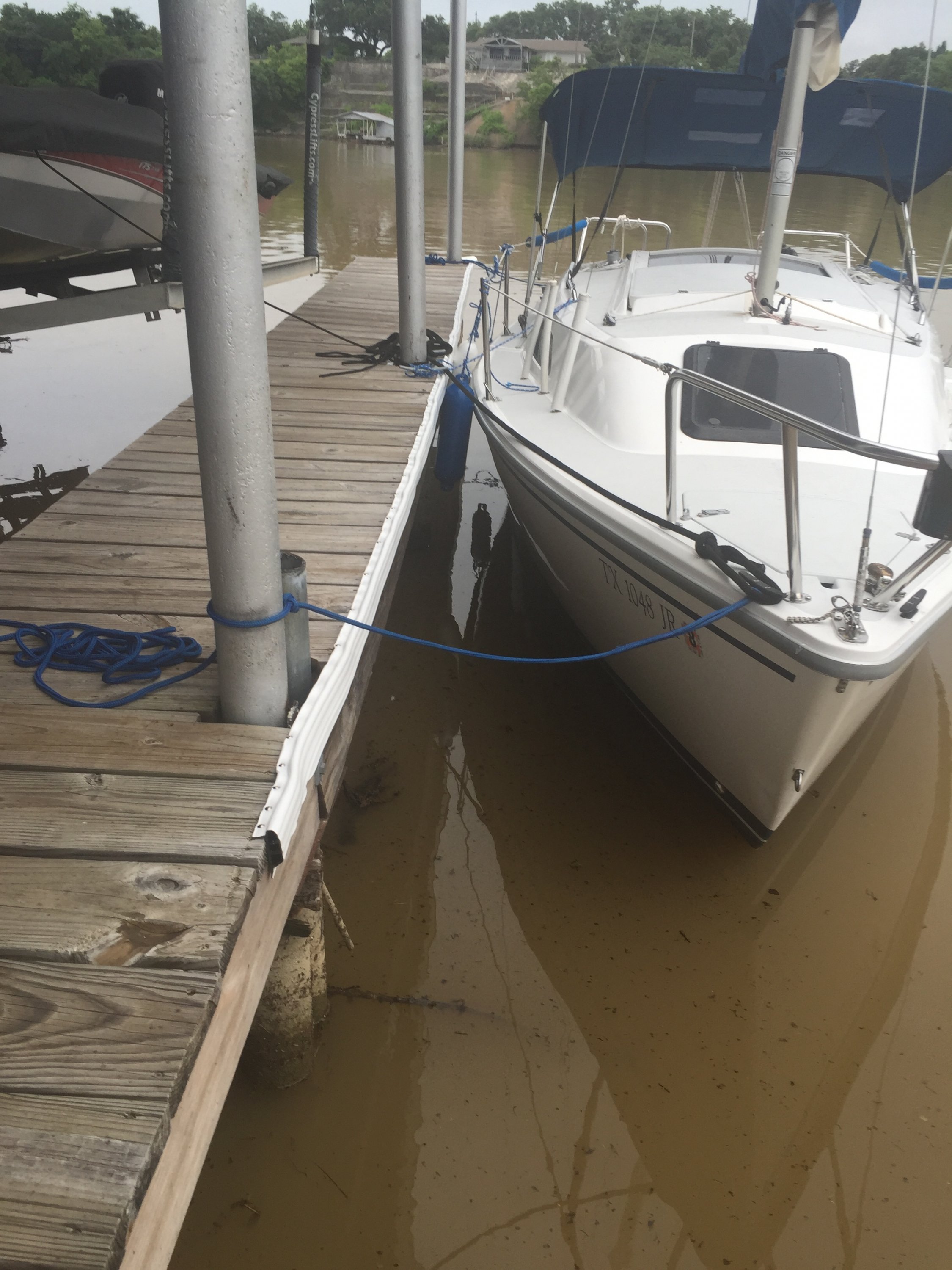

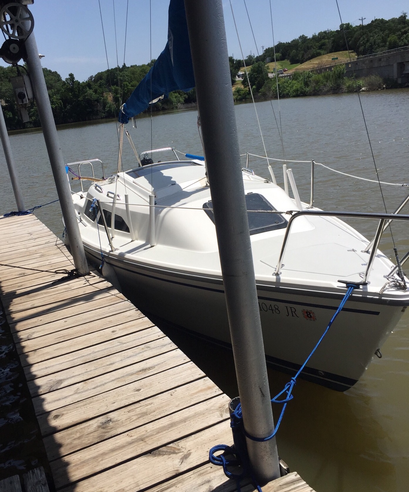

Last night we had some strong storms in North Texas. On my ranch I lost one tree and had damage to a few more from straight-line winds.
It had me worried about my boat.
All the slips on my lake are covered so I have to park on the end. Since I'm on the end, I can't use one of the hydro-lift to get out of the water.

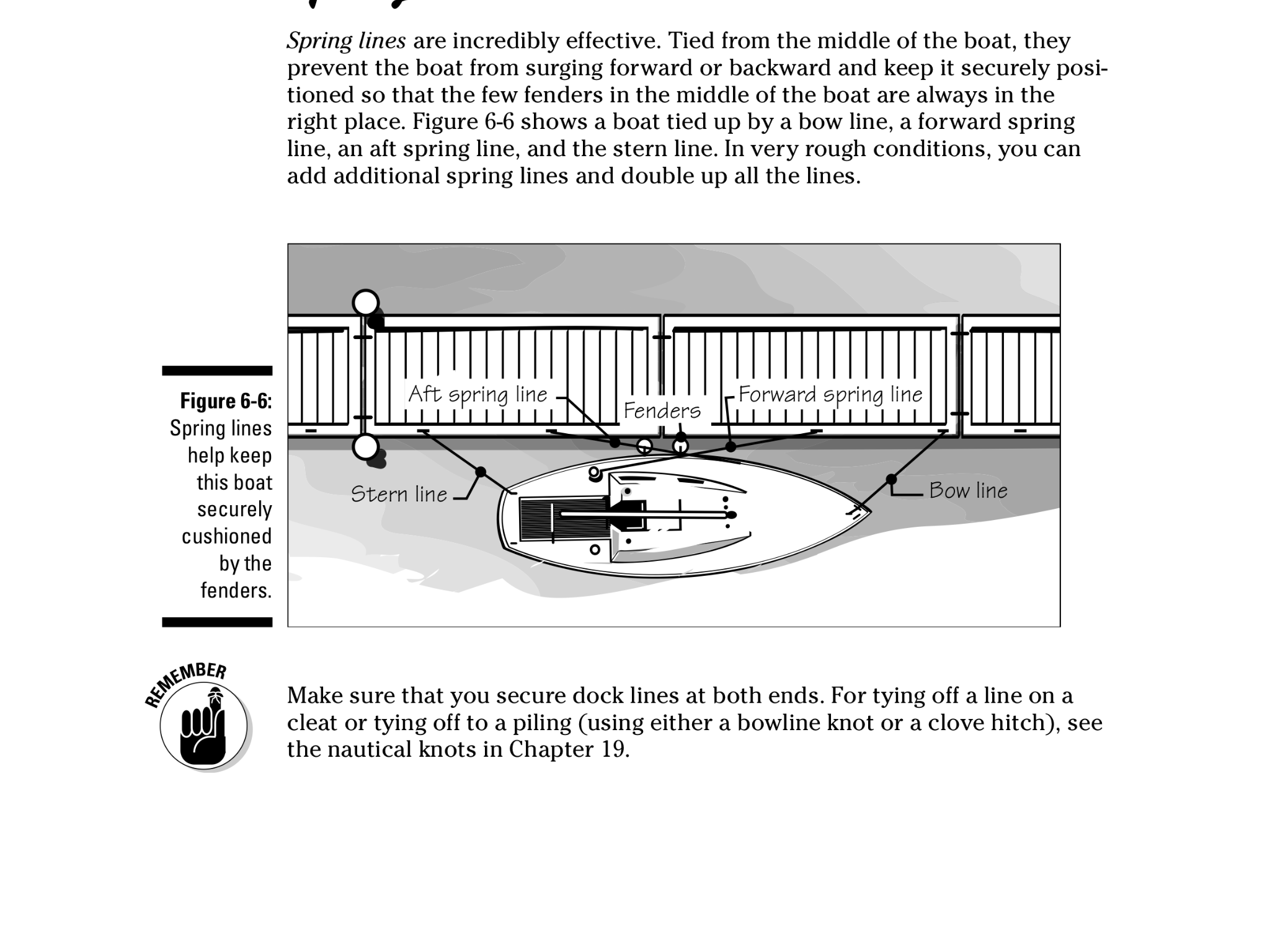

Please take a look at the picture and let me know if you think there is more I should be doing to protect the boat? Maybe spring lines?
The marina is in a cove and that does afford some protection. Also you can kind-of see in the background, the bridge behind the boat probably affords some protection since it's higher than the water, blocking some wind.
