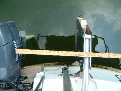

Dave, when my rudder (1995 H26) is fully deployed it is not parallel; the upper aft corner of the rudder is aft of the housing about 1 1/2", while the pivot point is nearly flush (see pic; it doesn't show it real clearly, but it wasn't taken for this purpose.) This means the bottom end of the rudder is slightly more forward than it would be if it wasn't fully up against the stop. Is this a problem, and if so, how does it affect performance?

Tom your's is like mine. Perhaps there were...
...slightly different designs or cuts of the rudder plates. If mine is set like Dave suggests then weather helm is much worse. I believe that when my rudder is fully down it is actually pointing slightly foward of vertical. Kind of like some experimental aircraft wings (and functioning in the same way). I think it's called a super-critical design? It does cause the tiller to swing hard to one side if released though. One day after I get the stock forestay (with CDI furler) shorted, I will see if pulling the mast foward helps the weather helm. Dave? alan
