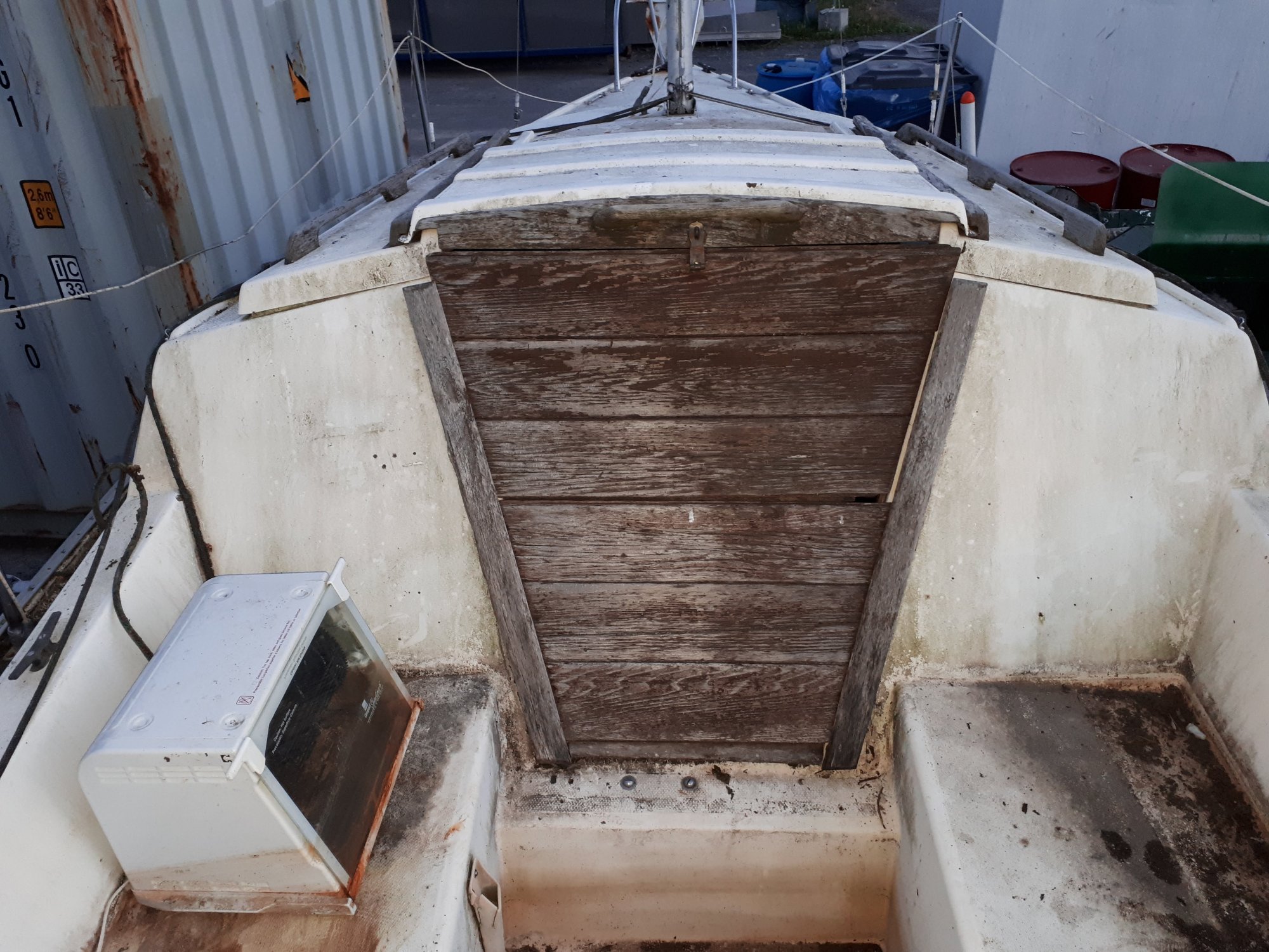

So the first biggie is the Weather, Hatch, or Crib Boards (I've seen them called so many names). I think the current boards might be original? They appear to be tongue and groove boards, they're pretty beat up and each (top and bottom sections) have an aluminum brace on the inside holding them together.
I've attached a picture showing the boards, actually looking at the photo I'm questioning my early statement about them being original. They appear to be too narrow (at least the top one), they are also too short. When latched like in the photo there is a narrow gap between the sections, when not latched the gap is between the top board and the sliding cover.
I assume that the cover should overhang the boards and not be flush as it currently is.

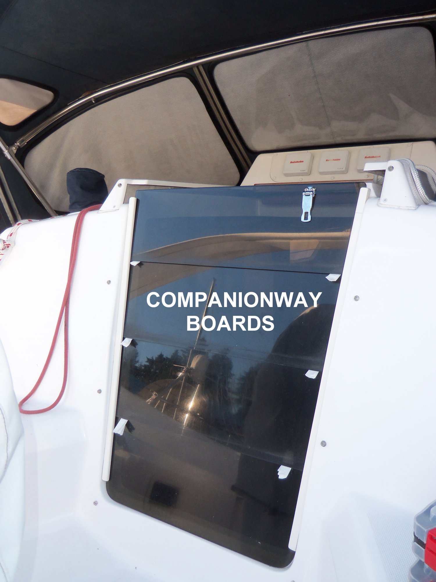

Cleaning and varnishing stained hatch boards is not my idea of fun and I'm a hobby wood worker. Do yourself a favour and use smoked acrylic or at least Star Board. The acrylic allows for lots of light below. Both are great to work with wood working tools.
This consists of four 1/2" thick boards. The pieces of paper towel show where the boards sit.

Did you rabbit cut the acrylic or do a 45 cut between each?
Those are the original acrylic boards from when I bought the boat new in 1998. The joint between each board is set at 45 deg. for water exclusion.
Routering acrylic is nice with carbide (only) bits, high speed, and very light pressure.
The boards are held in place with a routered rabbited strip of Starboard on each side.

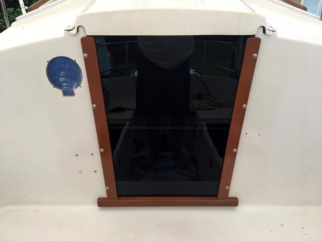

I used 1/2" smoked acrylic for our Albin Vega's boards. I had them rabbet cut at a local cabinet shop. Worked great, looks good (IMO). Original boards were in three pieces, but I went with two.
I used to have a photo of a C22 with acrylic boards, but I seem to have misplaced it. This is the Vega:

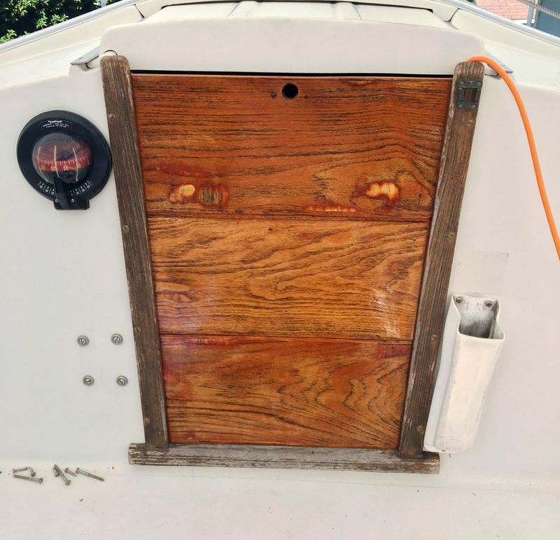

Along these lines, I happen to have a set of starboard hatch boards the PO made, and also the original teak hatch boards - re-finished with a heavy saturation of epoxy, and then clear gloss spar varnish. Between the two, there's a noticeable difference - in that the starboard set are clearly heavier than the teak, and much less stiff. I'd imagine that if one wanted to, you could pretty easily kick-in the starboard boards, and gain entry. Outside of that, they both work great, but a big advantage of the starboard is that they'll likely never need any maintenance. The epoxied teak still looks great at 2 years so far though-

I refinished my teak boards in much the same way -- started with 40 grit sand paper and worked up to 320. Then several coats of West systems epoxy (what I had on hand). After ~ 3 coats they really look amazing. Still need to put a couple of coats of spar varnish on them before installation. Most of the rest of the companion way trim I re-made with white oak. No where near as dark as the teak, but it's solid, weather resistant (even more so with a couple coats of epoxy and varnish) and I don't think it looks bad. I also have a single-piece plastic board (not see through) that the PO used for longer term storage.
