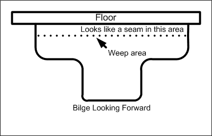

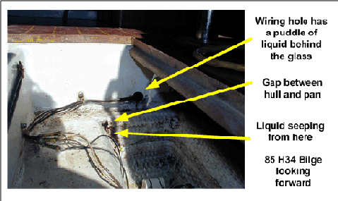

While cleaning and drying the bilge area on the '85 H-34, we bought last year, I found that there is water seeping in past the screws that hold the bilge pump and switch (screwed to the base of the bilge), as well as through a 1" long hairline crack where the floor of the bilge meets the wall of the bilge, next to the bilge pump base.These are in the main bilge next to the aft dining seat, not near the keel bolts. The leakage rate is about 1 teaspoon per minuteHas anyone experienced this problem? What was remedy? How serious, structurally integral, etc.?I've checked the archives and find only references to cracks near the keel bolts. this is not near keel bolts...
