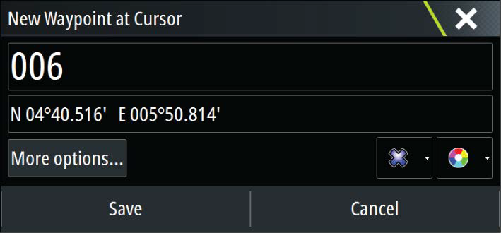

I entered a number of waypoints this morning into my B&G Zeus3 chartplotter. They are saved, as they do appear in the list. I selected "show icon and title" for all. Yet when I look on the display they do not appear. What might I have done wrong?
I am not at the boat and thinking about it, perhaps the longitude was marked as E instead of W; a silly error. But then, the graphic below is from the owner's manual. That location is inland in Nigeria.

Did you save them by entering coordinates or by selecting a place on the chart? Entering coordinates is more likely error prone than picking on the chart. If you go into the waypoint list is there any way to select the waypoint and center the chart on it? That would show you where the plotter thinks it is, so you could tell if it’s displaying a mark where it thinks it belongs, or if it’s hiding it.

There are times when it takes time for everything to load and display properly. It doesn't hurt to double check your coordinates, and verify settings under the "More Options" from the dialogue box, above. It may also take a particular zoom level, or display panel for things to appear. I know that I have waypoints that I have entered, which do appear on my chart as I travel near by ("Whale sighting!"). But, I also know that even things like current and tide indicators or values may not be accurate for a couple of minutes after they first appear on the screen. You could try selecting one of your waypoints and then ask the system to navigate to it, that might display it.

On my system, there are options in Waypoints to display name and icon for each individual waypoint (page 38). But, there is a checkbox under Settings then Chart, to display Waypoints (along with Laylines, Range Rings, Grid lines, etc... eventually, on page 37).

SoSound nailed it. You would think displaying waypoints would the default......
The rest of the story: Before I went down the path SoSound suggested, I mucked around in various settings. Nope. Then I followed the suggested path and the waypoints appeared!
