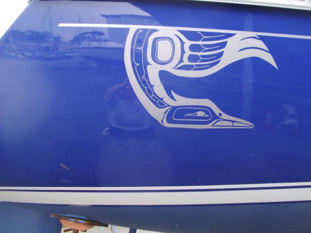

Imron will do quite nicely over time just washing it.
Here's a picture of my ten year old Imron that's never been waxed.
