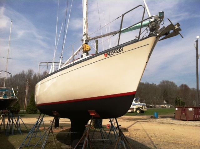

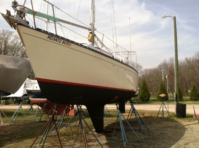

Do yourself a large favor in time and expense. Go online and read about PolyGlow and New Glass2. I use New Glass, and have for years. Last week my Admiral and myself removed last season's treatment, with the old dirt and grime, and applied a brand new set of light coats (6) in an afternoon to the hull. Looks great and lasts the season. hint not in the instructions if you go this way. Use a swifter with the long handle and wrap the head with a ShamWow type of pad. Better than the chamois I used to use. You do not have to go up and down the ladder with this method. (always do it with the boat up on the hard just before launch.
You pay your money and you take your choice.
Good Luck.
p.s. For years we used 3M heavy oxidation one-step with electric buffers and rags- I now ask myself why did we ever do that?
pps: I have just added a couple of pictures, as this is turning into a contest. Who can beat this with under four hours work-start to finish?

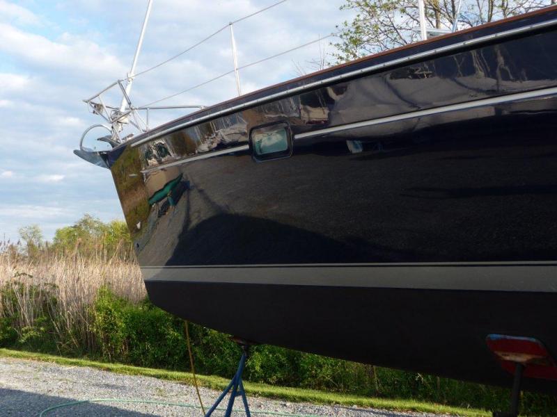

This is my hull BEFORE waxing. That is blue gelcoat compounded and polished the MaineSail way. If you do this, and use a quality wax (Collinite) it gets easier every year.
