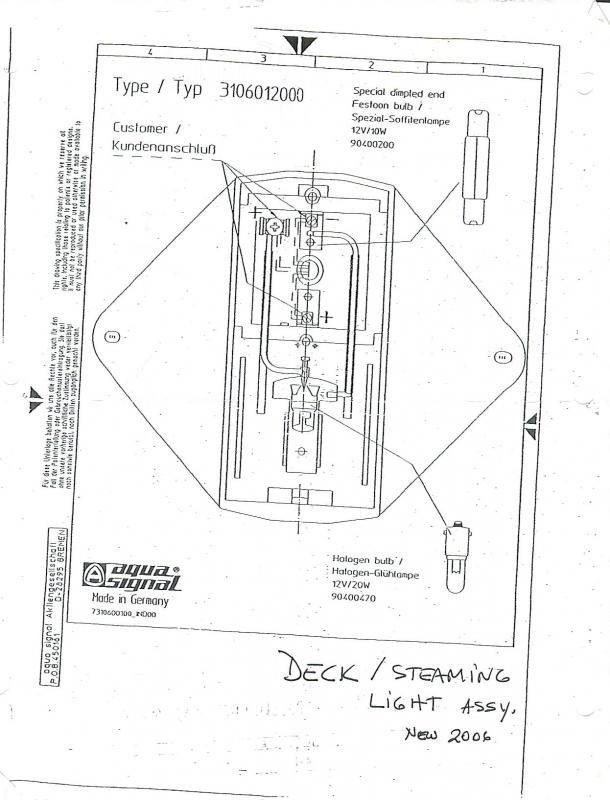

The foredeck and steaming light combo on our 1996 376 has a burnt out foredecklight bulb. steaming light works ok. I would like to know the wattage and type of bulb used before I go up the mast. Any help would be appreciated. Thanks

I recently replaced mine on 2002 386. It was 35 watts. I believe the model number of the the lamp is PAR 36. Very easy to change, it just snaps in after connecting the wires. Good luck.

Re: deck steaming combo
Sorry, the information I provided was for a 386. It is an entirely different lamp.
