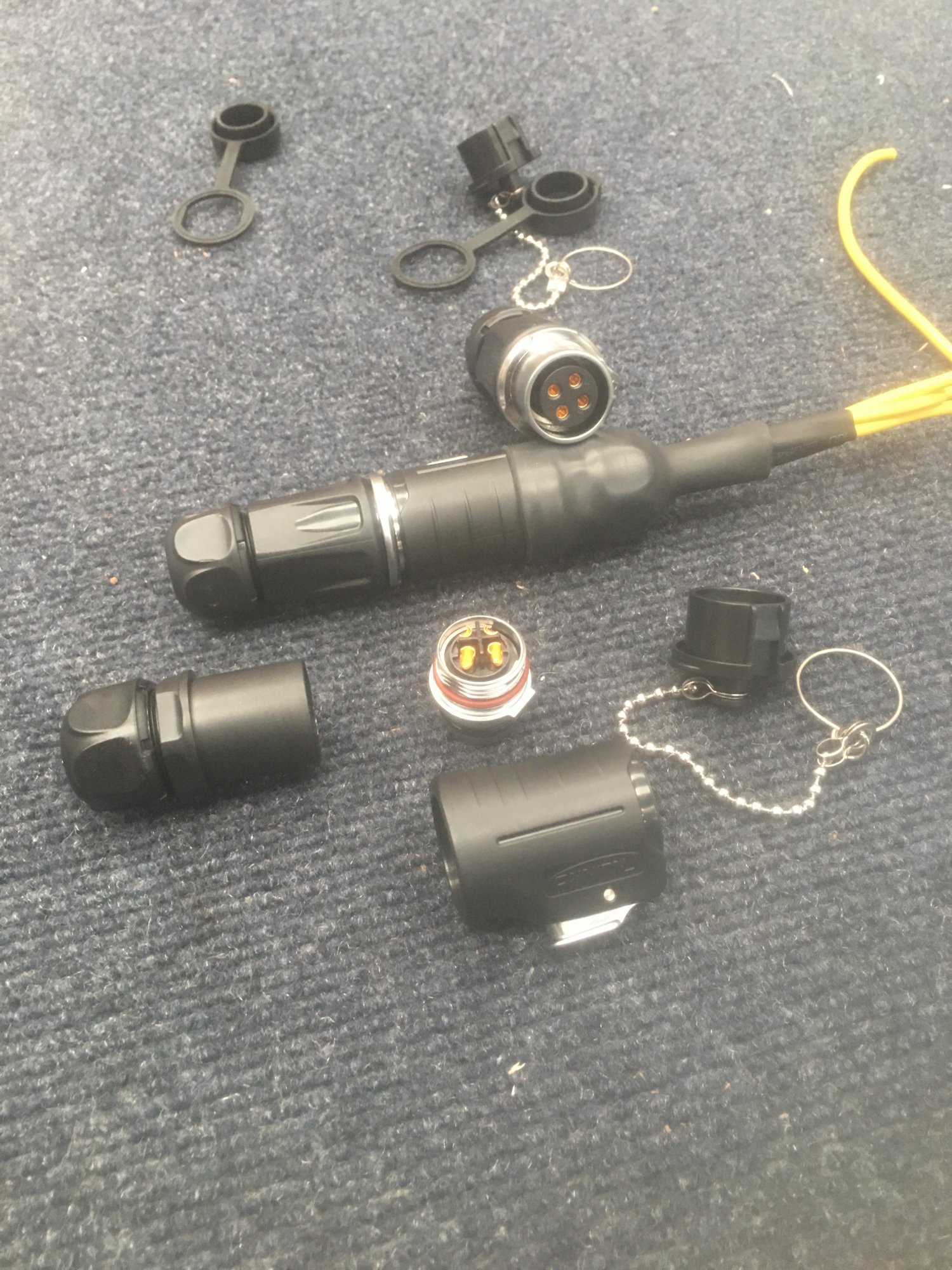

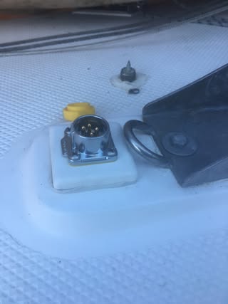

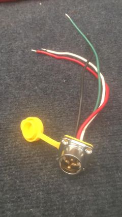

I have had these on my CATALINA 22 for about 4 years now and there great.
CNLinko
Here are the plugs , 4pin
CNLINKO 4 Pin Power Connector Cable to Cable, Plug w/ Receptacles Waterproof M20 | eBay
Here is the deck plug
ONce I have the plugs I do a series of heat shrenk tubes starting over the plug and going down the wires.

JBP, I've owned my boat for a little over 7 years now. It came with a SeaDog 4 pin deck connector. It was total crap. I thought by being the stainless steel one it would be better but it was crap as well. I personally would never use one again. I've had great success with the CNLinko products. They do take a bit of DYI to set up but the one I have now has been on my boat for over 4 years now. Best of luck to you.

Mar 2, 2018
236
Catalina Wing Keel San Diego
JBP, Looks like it's the same.
For mine I use 3 sizes of shrenk tubing. 1st one is the size of the wires. 2nd is the size of the back screw cap on the connector. 3rd is the size of the entire connector body so by the time all 3 are srunk down it's very waterproof. When buying to shrenk tubing you have to make your you get the right rate of shrinking,
