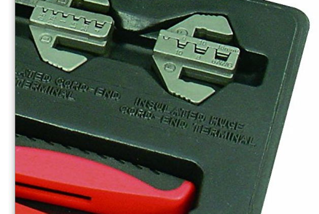

Having done a bunch of auto and RV electrical work, I say to HELL with soldering. I’m done with that unless we’re talking about a circuit board. As far as I’m concerned soldered connections have no business on a vehicle of any kind.
Get yourself one of these:
https://www.amazon.com/Astro-9477-Professional-Interchangeable-Tool/dp/B0045CUMLQ?th=1&psc=1
Has interchangeable dies for different styles of crimping. Is even capable of crimping open barrel pins for weatherpack connectors, as well as all kinds of insulated and non insulated crimp connectors. Use with heat shrink butt connectors and as long as you get a full stroke on the crimper you’ll never have an issue.
True story: about 4 years ago I was working on a mid-2000’s Jeep Grand Cherokee. Trying to diagnose a car that was completely dead. Had a fully charged battery, but no dash lights, no crank, no start. Come to find out the entire security system including locks, alarm, immobilizer, etc is all contained within the driver’s door, since it’s all an extension of the power lock system. There is a 10ga ground wire going through the accordion boot between the door and the body of the car. Chrysler, in their infinite wisdom, spliced the ground wire, with solder and heat shrink, right in the middle of the accordion boot. So every time you opened and shut the driver’s door, the splice would work back and forth and eventually it failed. Poof! Dead car!
Every wiring harness on a vehicle (and I mean vehicle in the broadest sense—planes, trains, boats, autos) has the potential to be exposed to vibration. Vibration makes soldered connections fail.
So count me firmly in team crimp.
