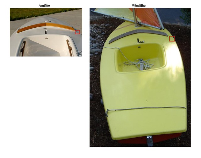

Our old Windflite14 seems to be full of water, and we don't know how to drain it. Any advice?
On the flip side of the Laser forum CalebD pointed you to is a forum for Sunfish. I found this picture and several discussions about drying Sunfish in there. Since Windflite was made by AMF as a sister to the Sunfish, good chance all their information is usable.
It looks like a Windflite has the same deck drainplug a Sunfish has (red box in the picture). Talk is they put the drain there so kids can just roll the boat up on its side instead of hefting the bow over their head like a transom drain needs. Unscrew the drain plug and let the water out.
