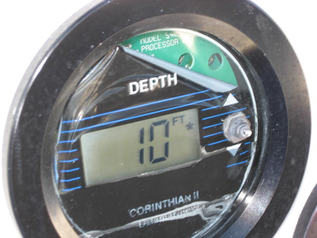

Hello Mlampner:
Presume you have the units similar to my picture below? (The peeling faceplate decal subsequently on this unit has been removed and I simply painted the inside of the glass with black paint -- looks fine.)
Just to be clear, the water has gotten into the housings right behind the face-plates?
If so, how are you with a soldering iron? I ask because before totally writing off your original DataMarine stuff, remelting every solder contact on the circuit boards and elsewhere with a low watt sharp point soldering iron sometimes will correct a bad contact or two and get electronic gear working again. I was able to do this a couple of years ago with either my knotmeter or depth unit (don't remember which). Of course your water intrusion might have shorted out and damaged or permanently opened up something. But the effort is worth a try and costs virtually nothing. What's the downside? Also many years ago, some of the fancy electronic systems on a 1989 Jaguar I owned starting acting up. I read about the remelting trick, located the circuit boards for the problem systems, and remelted the solder connects. The problems went away. Another thing to do is disconnect/reconnect the wiring harnesses from their male/female connectors. This might restore electrical connectivity, if some corrosion has taken place.
Since the Data Marine circuit boards are 1970's-early 1980's design, they are HUGE compared to modern day ones. There is space enough between solder point to re-solder if careful. By disconnecting the wiring harness plugs and removing the switches that are mounted through glass face plates, the circuit boards can be removed from the housings, without removing the entire unit from the bulkhead.

Certainly worth a try. Mine are Standard Horizons but assume roughly the same age and size.
Used to be fairly handy with a soldering iron till everything became disposable. Will give it a try absolutely nothing to lose.
